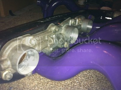

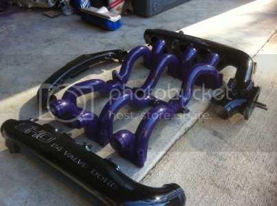

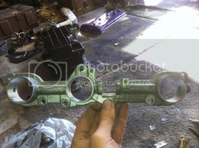

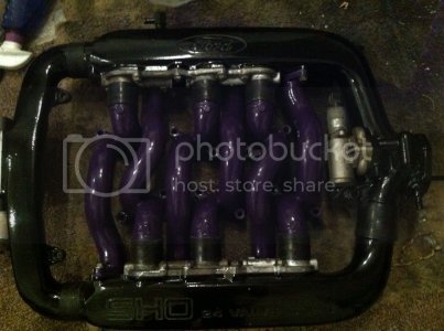

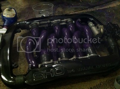

Gutted butterflys
F FB81 419B 8293 A021E8347000 437 00000039D3F35615
I ended up port matching the butterflys to the tanks. I didnt take pics of this because it was not pretty and I was disappointed with the work. But you can see how much material needed to be removed.

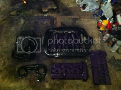

Pulled the g3 subframe today. Going to strip it and paint it and make sure everything is sparkly clean.

Is that purple paint any kind of special high temp stuff or just regular spray paint? I love it man :thumb:

Just regular paint, no high temp stuff. The purple has about 3-4 coats of clear. The black has about 9 coats of clear lol
