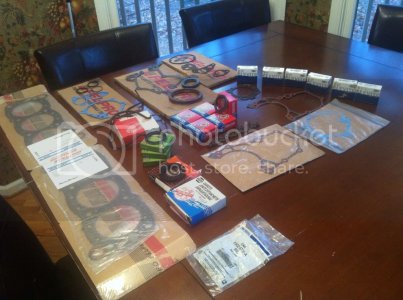

OK so all the parts are ordered.
12.5:1 Forged Wiseco pistons
HD skirts (for nitrous)
22mm pin
KOB rods
93mm bore 3.3L
Also bought all the gaskets today, Head gaskets, oil pump gaskets, oil pan gasket, water pump gasket with o rings, oil pickup tube gasket, and oil dipstick tube.
Already got my new clevite rod bearings, cam seals, and valve stem seals.
22mm pin
KOB rods
93mm bore 3.3L
Awesome!!! Are you going with a 3.0 or 3.2 oil pump?
