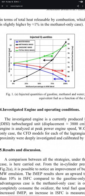

I have tried to step in and allow both of you to save face, but stop the madness: meth is not “cooling only”
i’ve followed both threads. this needs to end because the “cooling only / no tuning needed” meth narrative is just wrong at a basic engine level.
this isn’t opinion. it’s physics and there is real science behind this I have been researching since this all started.
strike 1: meth is fuel, not magic water
fact: 100% meth is a fuel. stoich is ~6.4:1 vs gasoline 14.7:1
if you spray meaningful meth (10–20% fuel mass) and don’t pull gasoline, the engine runs way rich
that’s not “safe rich”, that’s cylinder wash / oil dilution / ring wear rich
widebands can correct some, but they’re not meant to compensate for a major unmetered fuel source
running stupid rich to avoid liability isn’t safety, it’s slow damage.
strike 2: no meth timing = no real gains
the point of meth is octane
the point of octane is reaching mbt timing
letting auto-octane logic “creep up” means you never actually hit mbt, especially on short pulls
you get the cooling safety net, not the power you paid for
that’s a deliberately neutered setup.
bottom line
small nozzle, mild meth? fine, pcm can handle it.
big nozzle, real meth flow? it must be tuned for.
calling meth “just cooling” is misleading.
it is fuel.
fuel requires tuning.
everything else is liability management dressed up as tech advice.
now some factful posts and sites since there needs to be less personal opinion and more direct referenced information
22 pages long and a great read: https://energy.mit.edu/wp-content/uploads/2008/01/MIT-LFEE-08-001-RP.pdf
this is written in plane ole English: https://grassrootsmotorsports.com/articles/watermethanol-injection-kit-tuning-aid-you-need/
so when I started working with my HP tuner I started paying for these courses I recomment Matt you pay for some lessons because I am sure they will tell you meth is a cooling only non fuel: https://www.hpacademy.com/previous-webinars/069-watermeth-injection-tuning-motec-m150/
I know I know diesel but regardless it still applies and would be great for @SM105K since he asked about it earlier. https://www.mdpi.com/2077-1312/13/5/949
and lastly a more technical read but very informative, after seeing the charts how could you or anyone say just cooling over tuning and making the changes for the PCM to adapt properly....
https://www.researchgate.net/public..._Turbocharged_GDI_Engine_Comparative_Analysis
Matt dude just admit to yourself u do this machination for your own preservation. less time adjusting for each daily driver car you tune for and for your liability in making the wrong adjustments.
we are not talking about the deviation of someone adding gas that has 92 and not 93 octane as an overly simple example. btw for both of you other than cheerleaders most of the main audience in these threads have tuned the fck out.
802 for your argument and I believe your position it would be best to cool off I get why you are angry misinformation like this makes it hard to stay on track and people start believing the non factual argument.
Matt dude, don't know ya but please this is grief posting at this point. the more you post the more you put yourself out for scrutiny and discredits your cache here amoung the tone and mean tons of referals members make to your business. but for all you say 802 sounding crazy, it's because his point is correct and I can see how it's making him crazy in. each post.
seriously enough everyone this is madness
