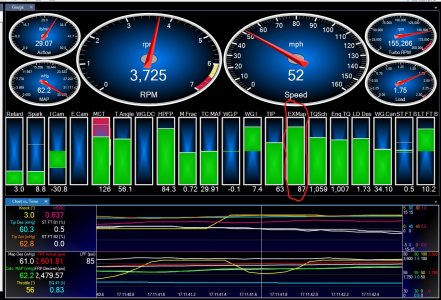

Exhaust drive pressure is quite important. A good example of what you’re saying is found in a LegitStreetCars video, at 21:46 he explains how a larger compressor wheel is the main contributing factor to the increase in power (aka. less back pressure, freer flowing). He also mentions that the stock housing and the new turbo housing are identical. If you want to see for yourself:
Yep, the factory exhaust housing is a restriction above 500 WHP on E30. It isn't the inlet of the exhaust housing that is the problem, look up the definition of turbo AR. Even with a bigger turbine wheel (exhaust wheel) you are actually making the AR smaller which hurts top end. The GH turbos have bigger wheels on both ends unlike some of the others out there for less money, but you can only go so far with the factory housing. I even experimented with some extrude honed housings and they only picked up 10 HP.
Also, it might be a surprise to some in here but the exhaust backpressure is modeled in the calibration where the VE is changed because of more or less backpressure and a few of us out there can actually correct for the flawed factory model past about 400 WHP on some vehicles where it goes wonky and gets out of hand and make it match reality. I was saving this for another topic, but like I said in another thread, The Calibration Takes Care of It. See below:
