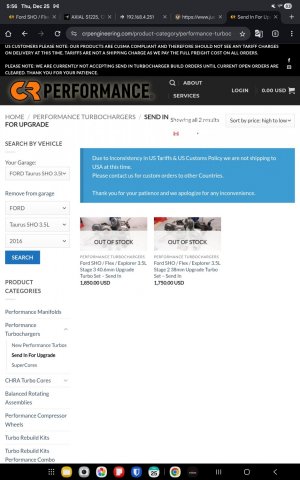

Debating on upgrading turbos on the 16 for a street/strip car what are some of the better turbo options? (Assume Matt to say gh want to compare gains w price). Seen stages 1-3 from various places 3s having i wanna say 40.6mm vs 34ish stocks. If stage 3 is couple hundred more than 2 would to the over ****.
I would personally go with the options at CR performance. the biggest questions to ask yourself fast spool speeds or higher end boost to push the car thru the 1/4?
I am not going to debate the vendor differences, but this would be my option with tarrifs and all. they can speak to you about your goals and that would be my direction, they provide bench tests and certified turbos when completed.
I was looking at them the other day an on there home page said wasnt shipping to the us an even there in stock stuff couldn't add to cart
Give them a call and see you are paying the cost of tarrifs to ship into US.
