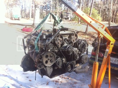

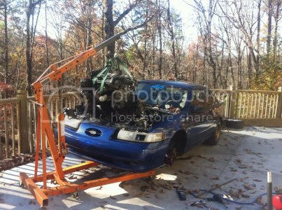

Well after popping another transmission and destroying a axle I decided to retire the blue turd for the winter. Planned on quite a few upgrades but then I decided if im going to do it I better do it right. So here is a little preview of what I have planned to push my N/A SHO to new heights.
So I started by pulling out everything.

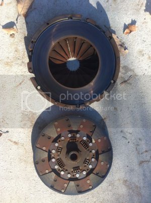

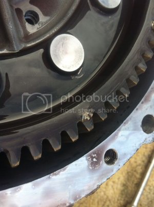

Out with the old Southbend Stage II clutch
 5213 4169 8D7C 1BC684BF6C66 2705 0000027AD7119C28
 01C3 4172 B647 A8F6C5059F31 2705 0000027B79C5C0E6
 A923 4F45 900E 94E60A8B4DDD 2705 0000027B7D360A98

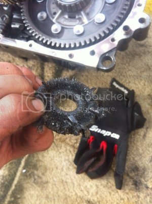

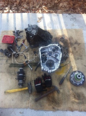

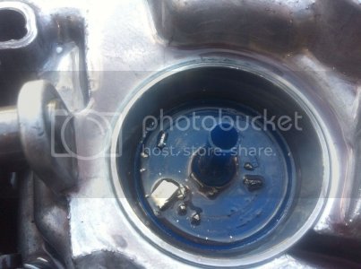

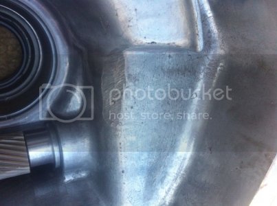

Ok, then I started disassembling the transmission. I destroyed 3rd/4th syncros and have been beating on it pretty hard even with zero syncro left. Here are the carnage pics.
 628D 4E56 B8B8 D6C214AD30D0 2705 0000027A89D7ABFF
Piece of syncro LOL
 D458 4E49 A969 20C6D607C652 2705 0000027A8F8D0F81
 DFBA 4554 ACAE A7E51B54B0C0 2705 0000027A94ABC003
 C20D 4342 9069 22222EB3B1F7 2705 0000027A998B1444
 0E34 4AED A014 33419BD1E494 2705 0000027AAEC3321C
 1B8C 41CD ABBE 6B003EE0F948 2705 0000027AA8A0162D
 40EB 4C42 96E8 8880579B85F5 2705 0000027AA2286830

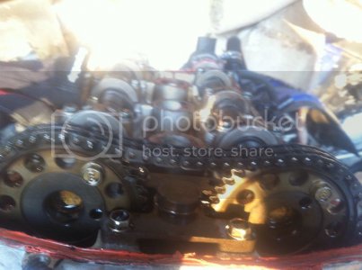

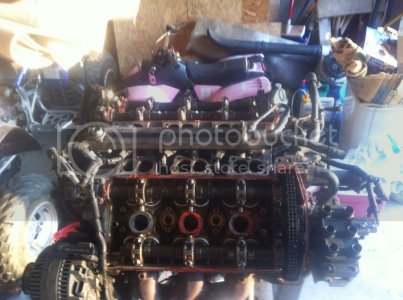

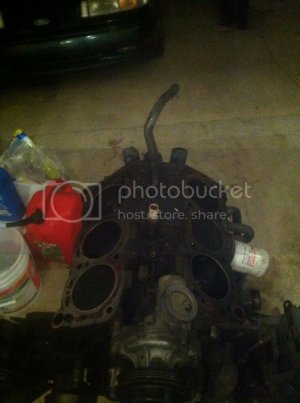

Then I started tearing down the motor.
 B2F4 4206 B607 D479D07F7A2A 2705 0000027AB3BF0E5C
 638E 43C5 90AA D5277970547B 2705 0000027AB8952C65
 2BEB 4F5D B873 0DD8C265BAAB 2705 0000027AC2A290C8

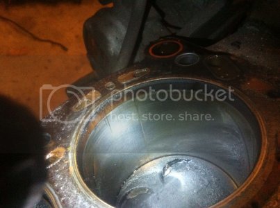

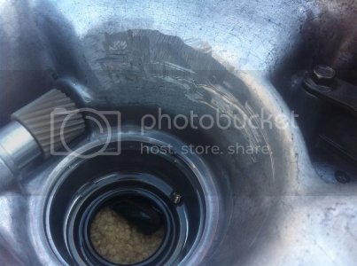

Then I discovered this. This is DEEP.
 D1DF 4E39 8418 0BE0841C0F99 2705 0000027AC7867146
Now for the good stuff.
So now seeing that gouge it changed my decision to keep my 92mm bore. I spoke with wiseco over the phone the other day so I could get just a quote on some pistons. I have decided to go with a 12:1 compression forged piston with for a 93mm bore. The heads are getting completely disassembled, Going to port and polish the heads, remove all casting marks, bowls blended, intake ports finished to a 120grit, exhaust ports mirror polished and then assembled with new valve stem seals and SHOSHOP Stage II cams. The intake manifold will be hogged out and port matched to the heads. Gutting the secondaries and just leaving the 40mm housing since the car is never below 4000rpm.

How did the cylinder get scored like that? How are you going to prevent it from happening again? Just need the trans to hold together for more than 1 second now :)
zach44102
BIG TURBO
Jan 6, 2010
2,655
1,651
Georgia
Im not sure exactly how it got scored but i bet you it has been that way ever since i first started the motor considering it make lots of wierd not so good sounds. A piece of gravel, glass, or sand had to had fallen down in the cylinder.
