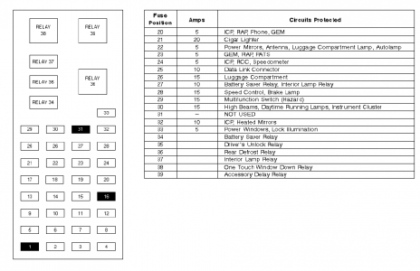

I think there is a 5 amp mini fuse #24 that controls ICP, RCC, speedometer
There is also a 10 amp mini fuse #9 labelled ABS

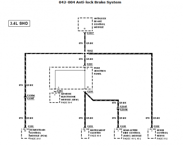

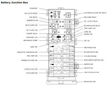

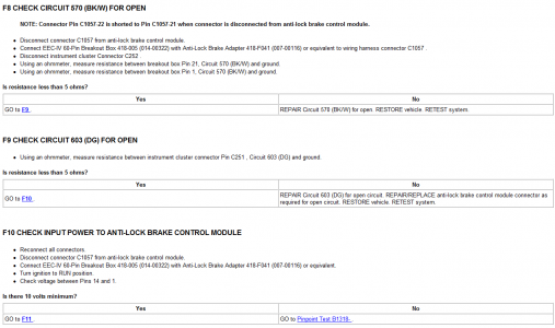

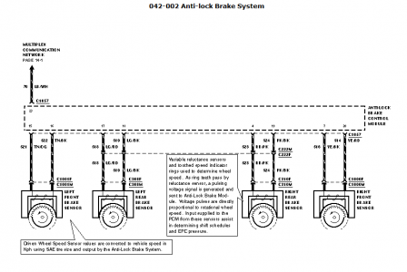

Vehicle Speed Circuit Check
P0500: CHECK VEHICLE SPEED PID​
  • Diagnostic Trouble Code (DTC) P0500 indicates the powertrain control module (PCM) detected an error in the vehicle speed information received from the anti-lock brake system (ABS) control module, generic electronic module (GEM) or central timer module (CTM).

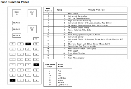

There are 4 fuses that affect the ABS. If the fuses are good and you don't get an ABS check light on the instrument cluster, the ABS module is probably bad.

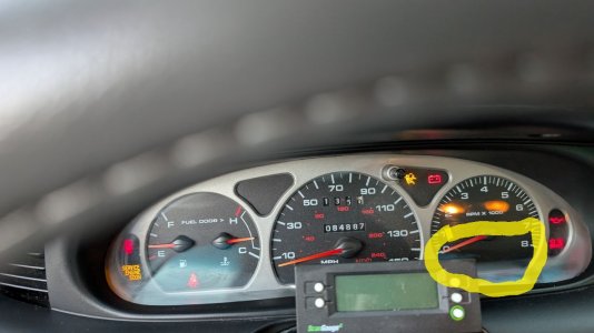

When I key on, this is what my dash looks like. I believe I SHOULD see an ABS yellow (amber) light show up somewhere in the yellow circle upon key ON position, but since it is missing, I am guessing the bulb is burned out?

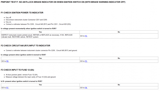

You should see the ABS light prove out every ignition cycle. The warning light is probably an LED. Regardless, from the service manual:
The indicators are not serviceable separately.

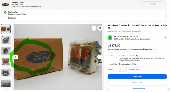

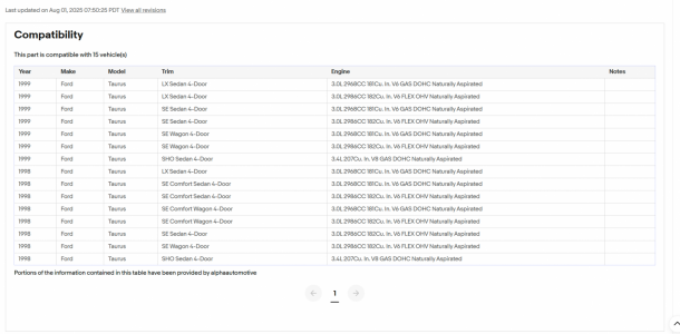

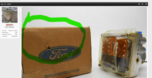

I saw this on eBay: Based on what I've read elsewhere on the forum, the ABS module is SHO specific, yet this eBay listing says it is compatible w/ Mercury Sable and other Tauri. Can anyone confirm if this ABS is SHO compatible? 1754202401214
1754202484593
Qshiplvr
May 28, 2016
225
147
P Springs
I saw this on eBay: Based on what I've read elsewhere on the forum, the ABS module is SHO specific, yet this eBay listing says it is compatible w/ Mercury Sable and other Tauri. Can anyone confirm if this ABS is SHO compatible? View attachment 95042
It's odd...I ran across this eBay listing, and it seems to use the EXACT same picture as the eBay listing I found back on 2017, same tear in the NOS box and everything... 1754204849316
Here's the post from 2017: 1754204960488

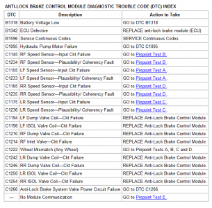

Do you have access to a diagnostic tool or FORScan? Scangauge will only read OBD codes. You need to read all codes. Otherwise you're just guessing.
The fact that the ABS light doesn't prove out or work tells me it's more than an ABS sensor.

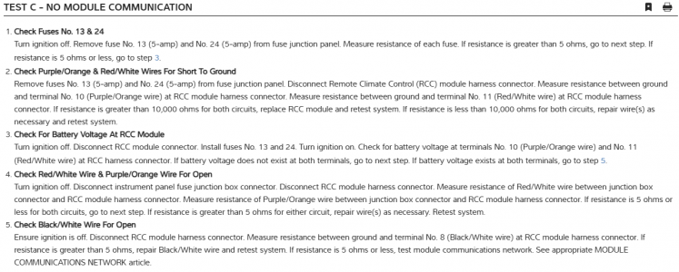

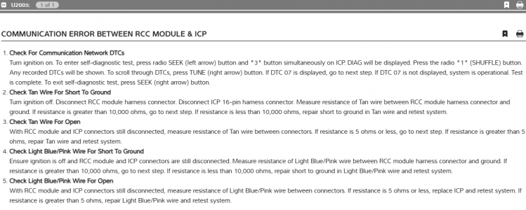

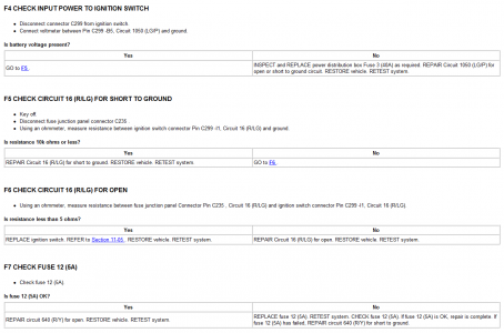

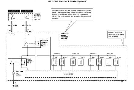

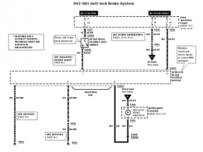

Since 99 was in the early stages of networking modules, hopefully you can get some useful information from your scan tool.
I revised my earlier post to show the correct fuse panels and wiring diagram for 99MY.

Well this is typically a loss of VSS signal. Seeing fron wheel bearings where done recently, check the sensor there first as it could have been damaged. However, rears are the most common problem.
What is the correct part number for the VSS on a '99 SHO? Rockauto seems to sell a couple of different versions (the plugs are obviously different), so can't really tell which one will fit a '99 SHO AX4N transmission.
gamefanatic
Feb 20, 2005
790
288
Barstow, CA
These don't have a VSS on the tranny. That's available only othe non-ABS models.
They are at each wheel so look at the ABS Wheel Speed sensors. There are too many to list.
Its unfortunate the mechanic power washed the engine bay. Unfortunately these older connectors don't handle this well (ask me how I know) as newer cars which have good insulation at the back of the connector as well as the connector its self.
