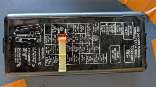

Looked under the driver’s side dash at the fuse box, I pulled ABS fuse #9 10A and tested w/ Fluke meter for continuity, tested fine. Sprayed DeOxitD5 on prongs and replaced.
DCVCHL 4tbt4BUg0n33BcEAkeyv3SwZGQxPx8PF3BVkpVYUQ
ABS 10A mini fuse pulled from fuse block located under driver's side dash over parking brake pedal

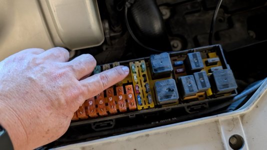

On to the high-powered fuses. Opened the power distribution block, pulled the 40 amp ABS M.A.X.I. (gatekeeper software doesn't like the term) fuse #13 and tested w/ Fluke meter for continuity, tested fine. Sprayed DeOxitD5 on prongs and replaced.
NElruaqh4fnNYm3XHqKasFwkeyv3SwZGQxPx8PF3BVkpVYUQ
Pulling out the ABS 40A M.A.X.I. fuse (I use periods due to gatekeeper software redaction otherwise)

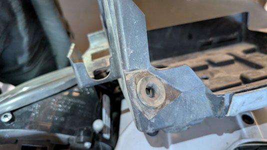

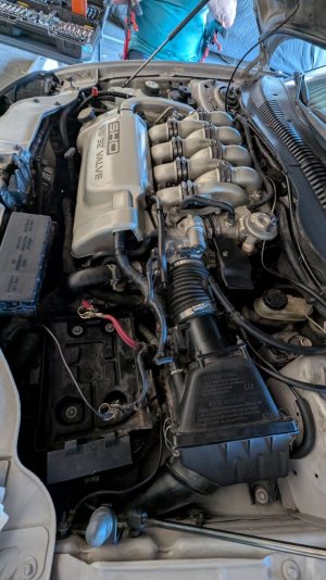

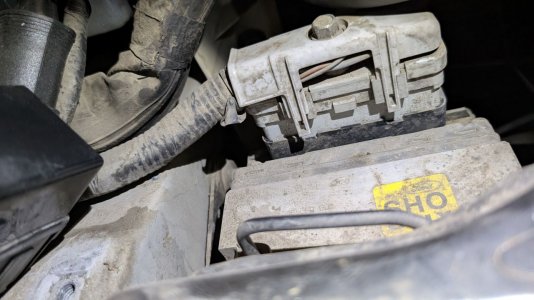

The ABS unit is located UNDERNEATH the battery tray, which is held in place by 4 x 10mm bolts. What isn’t obvious is there is a covered power sub-block clipped on to the right side of the battery tray that you need to wrangle loose, and there is a ball-tipped prong attached to the airbox that pokes thru a rubber grommet at the top right corner of the battery tray to hold it steady in place that is a bee-atch to unfasten. You need to lift from the bottom left corner up first, then tilt and rotate so you can un-fasten and push out the ball-tipped prong from its rubber grommet. Once I got the tray out, I was faced with a 10mm hex nut locking down thru the center of the harness plug the ABS wiring to the control unit.
ATuaHUjWYudSwwxPsbS9UANkeyv3SwZGQxPx8PF3BVkpVYUQ
Power sub block on right under 2 clips that is held in place by battery tray, need to wrangle it away while staying attached
WHgv4hFTkD1v5epHXiey0dQkeyv3SwZGQxPx8PF3BVkpVYUQ

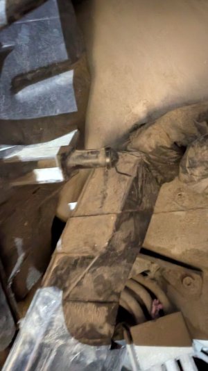

Rubber grommet on battery tray
FS38d6s1ee0SJQ58t8f3n6ikeyv3SwZGQxPx8PF3BVkpVYUQ
Ball tipped prong attached to airbox that fits into rubber grommet on battery tray

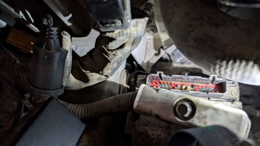

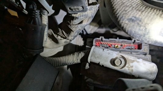

I noticed that there is a protective plastic cap on top of the connector that is held down by 4 grooved slats w/ a clip at the end. One of the slats was OUTSIDE its grooves, and it could have twisted the connector or caused it to have a sufficiently tenuous connection to go hinky (I’m hoping). I start wrenching, and wrenching, and wrenching, and wrenching…this plug is in there good! Took a good number of turns to back out that bolt, and I FINALLY got the plug separated. I doused both the male side (connected to the car) and female side with DeOxitD5 and separated the top protective cap then re-installed w/ all 4 grooved slats correctly seated and clipped down before re-attaching the two halves of the ABS controller plug and wrench back together.
1RAPXKNI5paqN ioJoGFhmQkeyv3SwZGQxPx8PF3BVkpVYUQ
What I saw after lifting out the battery tray
XWDy57Pvu4sj9nD24fjg71gkeyv3SwZGQxPx8PF3BVkpVYUQ
Notice left plastic guide outside of tracks compared to right side and how left side of plug is slightly higher
VyL dtscsvpcxEyOdn7XTtwkeyv3SwZGQxPx8PF3BVkpVYUQ

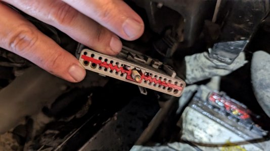

Unfastened ABS Controller plug after many, many, many cranks on the 10mm hex center lock nut
HRpzd3aS cavCH9xa KoT wkeyv3SwZGQxPx8PF3BVkpVYUQ

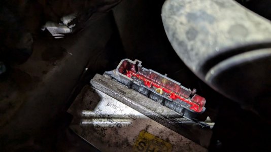

Better focus on male side plug ABS controller
DaVurBXUbyAlx1XpuTgaKoAkeyv3SwZGQxPx8PF3BVkpVYUQ
Female side of ABS controller plug
6NqWaKs06D6nAH2IgTBC9kgkeyv3SwZGQxPx8PF3BVkpVYUQ
DeOxITD5 doused male plug on ABS controller
HvkOAoaWDMycuf 6AYRPIEokeyv3SwZGQxPx8PF3BVkpVYUQ

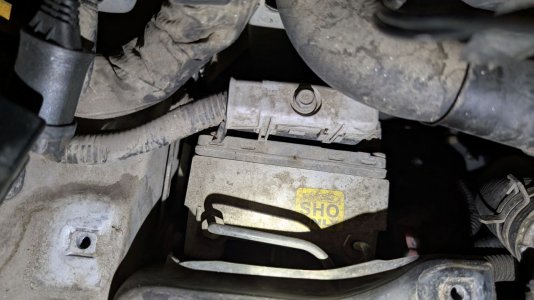

1999 (SHO only) ABS controller part number stamped on Bosch 927
Next popped the hood and removed the brand new Interstate Battery (2 wks old) because I was going to be fooling with the power distribution block high power fuses and manual said it was a good idea to disconnect the battery, so I did.
Son-of-a-gun this car drained a BRAND NEW (I trickled charged it until it was 100% before installing it 2 wks ago at mechanics house before driving it 70 miles home) 2 week old battery down BELOW 80%! Just sitting parked! So that means I’m going to let it trickle overnight in the tool shed tonight before re-installing it tomorrow (because I live in a condo w/ a carport, and don't have a dedicated garage).

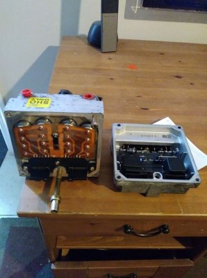

IIRC the ABS module for the SHO isn't the same for SLO (-> be very careful with Ebay and Amazon crossnumber system...) and they were able to manage a faulty abs sensor (no speedo = faulty module > faulty sensor). It could be not related to the wash too...
Also note that there were discussion that SHO ABS modules were differents between years too 96-97 vs 98-99.
Just to be sure, the number you need if you have to buy one is F8DC-2C346-BB, NOT F8CD-2C346-AB and new, they will have a yellow "SHO only" sticker (as your's).
(For others owners 1996-97 is F6DC-2C286-BA IIRC)

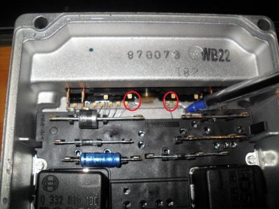

If its the module is going bad, most of the time, its the small internals soldering that just gives up. They can be repaired also (maybe less risky). According on what Im seeing on my photos, you don't have to unbolt all the module (and hoses) to repair them, only the missing part on the 2nd photo and part at the right on the 3rd. (No towing, no additionnal unwanted engine pressure washing, just small soldering in half of the box.)
I din't do this job myself, I'm just watching my bunch of archives photos so wait for a veteran to confirm what I'm saying for more security. ;)

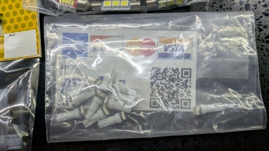

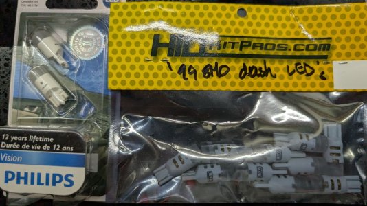

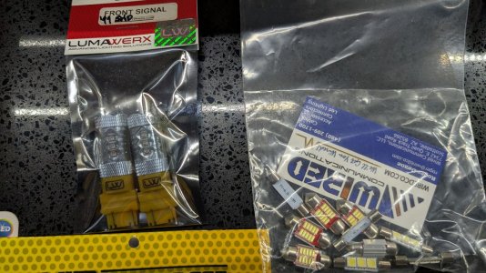

Turns out I think I may have been thinking ahead and already bought some. I found these in my SHO pile of stuff to do to the car
FXfZrZQASq9iVVVuch yMHekeyv3SwZGQxPx8PF3BVkpVYUQ
48mZ 4kudp7 sKpJpp0Vyuckeyv3SwZGQxPx8PF3BVkpVYUQ
WZuxTpEIaUal4z8  qFtf8wkeyv3SwZGQxPx8PF3BVkpVYUQ
95j7Gv0e1nfWlqUR BkqFiAkeyv3SwZGQxPx8PF3BVkpVYUQ
I guess I need to bust out the screwdriver and pull the dash out to replace some bulbs.
