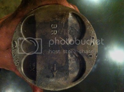

Went and pulled the pistons out of the storage box. Found this one. Took a wire wheel to it to you can see the damage in more detail.

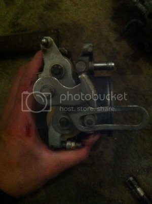

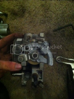

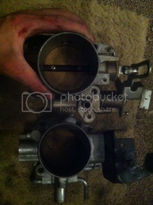

Got to thinking while going through boxes of old parts and I stumbled across a 75mm V8 SHO TB. That after some test fitting and getting a plan together I am going to modify to work for the v6 SHO Intake Manifold.
Here is a stock V8 throttle cable assembly.
7 E32A 47A3 A2B0 898BC3E38B27 753 000000B8D7281914
Here is a side by side comparison
8 FACF 4B89 9C4C 3CF37DE1703B 753 000000B8DDA5DB09
Here is the throttle cable assembly modified for the v6 cable assembly.
7 BFB0 48CD AB94 E2203D16D336 753 000000B8E204170A
Plans are to shave off most of the castings, redrill it and mount it to the manifold. The manifold is going to have to be opened up 6mm IIRC as well to match it. I should be starting on that within the week.

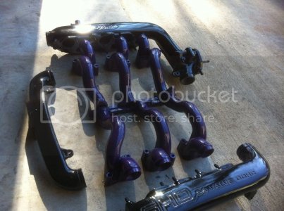

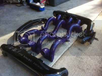

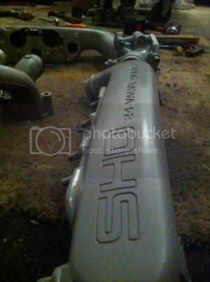

Other then that I got the intake all painted. Is not perfect but It looks a lot better then before.

Good thing you didn't chrome it. A certain pirate from AZ coulda swung thru there ;)
Like the color scheme. What do you hope to gain from the TB mod? Won't it need a tune to be effective?
jayro
Apr 8, 2006
1,918
349
Auburn, In
With his mods, a tune would probably help the whole thing run better. For just the TB a tune would not be nesacary. As long as the air is being metered as it go through the MAF, after that it doesn't matter too much as far as ECU tuning (within reason). His car appears to be built for 100% topend power. With the larger TB he could gain more flow at higher RPMs.
zach44102
BIG TURBO
Jan 6, 2010
2,655
1,651
Georgia
Yes jayro is correct. Tuning should not be required for the TB since im retaining the original TPS. I think the gains will be suprising to most. I would fully expect 5hp. If i do successfully modify the tb to work i will dyno stock vs 75mm
zak
May 15, 2002
1,771
497
east of Hartford
When you open the manifold up 6 mm, you will be making the radius between the throttleport and each side plenum very tight (assuming you re-radius and not leave a sharp edge). Short side radius minimization kills flow.
Its all a balancing act - not sure how many HP even a 68 or 69 mm throttlebody has ever shown on a SHO V6. Mustangs make 300 hp easily with 65 mm throttlebodies.

I plan on matching the plenem to the tb. No sharp edges. I would not ruin all the head work and intake work with a 6mm lip at the tb

Guess my point was there simply isn't enough meat on the intake opening ****** to swing a full 90 degree radius as you go up above 68/69 mm in diameter - you would break through to the outside unless its fairly sharp. Look closely you'll see what I mean.
Nive job on the short runners, my extrude hones ones are 38 mm in diameter.

Incorrect Zak, I think I know what your talking about. Are you talking about the plenus where the TB bolts to it? If so I have already Mic'd it and boring it to 76mm would leave 1.5mm of wall thickness.

I got a 75mm BBK mustang TB , besides messing up the idle , it doesnt do much.

You will need to tune the IAC for that, I can guarantee it.
