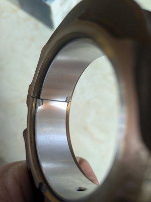

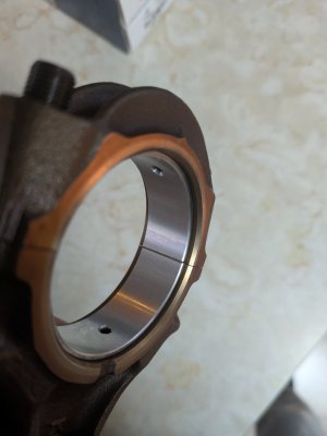

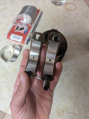

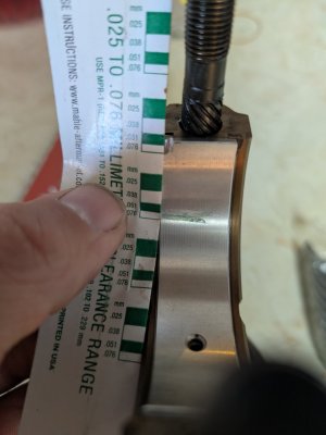

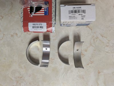

Alright, finally got a chance to test out and plastigage the DNJ RB270 STD Acura bearings. These are pretty close as well, the oil hole is just *slightly* off, and they're a little more narrow. Plastigauge was done with a 3.2 piston on a 3.2 crank, 2 stage torque 25ft/lbs and then 35ft/lbs, in position 4.

Those look close. 3 questions:
- what is the expected rod bearing clearance?
- how do you read a plastigauge? Are there two pieces that got smushed side by side? I assume the resulting width is the clearance measurement.
- how far off is the oil hole? I would think any noticeable offset from the rod hole to the bearing hole would be bad from an oil flow standpoint.

According to the manual we are going for:
0.024-0.056mm desired
0.08 allowable
In person that reads like somewhere close to 0.076 which is a little on the high side. Which does make me wonder if .25s would be better.
I can get a better picture of the hole alignment after work.
I think I still like the supras the best, if motivated enough to file some tangs. I like that they're wider.
