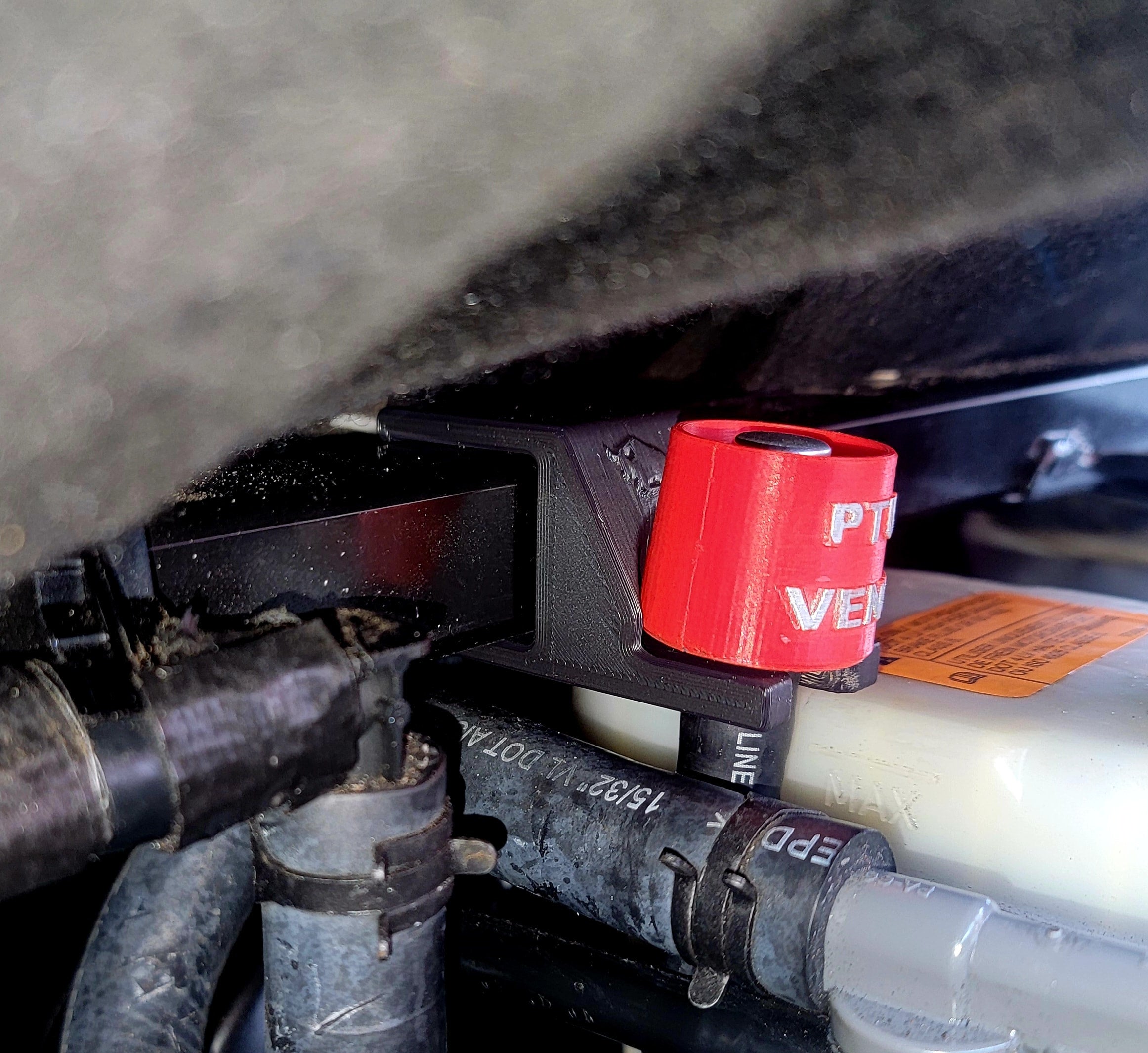

What's puzzling about your problem is the PTU fluid is always black and is in terrible condition when you change it. Even after just a few thousand miles?
No mention of how much your pulling out and how much your putting in? The PTU only holds what I consider a microscopic amount of fluid for what is does. I mean 18 oz? That's all? You can't get it all out either so at best without a drain plug it's only a partial fluid change.
My 2014 MKS is at 115 K miles so WAY less than yours. But my experience with PTU fluid changes is much different than yours? Yes the first couple had a good bit of black sludge/paste type crap in it. BUT as the miles went on and I kept changing the PTU the fluid went more and more honey colored and the black tapered off and finally disappeared.
My last fluid change at 110K Miles (Again Way less than you!) I was very surprised to see the nice condition of the PTU fluid I pulled out.
My opinion is the damage was done long before you got the car. I am convinced that early and consistent fluid changes are the number one thing an owner can do to prolong the life of the car.
Normally the PTU smell is described as a Propane type odor. Also you probably know this but with the massive amount of miles and the number of times you changed the PTU fluid. I would strongly consider adding a drain plug. Now yes this should have been done by Ford to aid in maintenance. But hey at least they did put a drain plug AND a dip stick in for the transmission!
Take a look and after owing the car for 10+ years (It's been the most reliable and has had the least repairs of any car I have ever owned or knew about!). I wish I had added the PTU drain plug the first week I owned the car! I may still do it.
