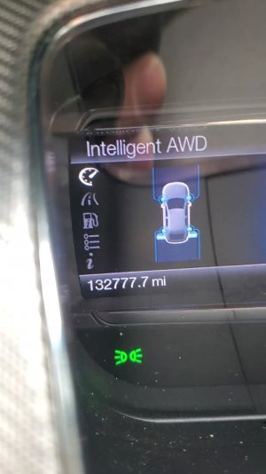

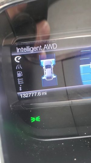

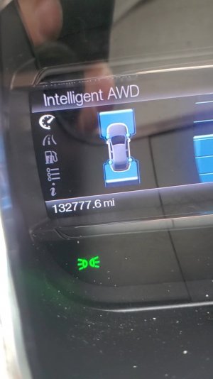

Now that's out of the way, my car hasn't had typical noises/ behaviors of what I've seen for ptu failure but its definitely something in the driveline around the middle of the car, noise is hard to pinpoint. I was watching my awd gauge and noticed the rear never fully goes away like the front does, only at a dead stop. So my thinking is possible rdu issue? I don't know, maybe it's normal gauge behavior. Here's a few screen shots of a video of mine for comparison, anyone with the gauge enabled can you take a look and see if yours behaves the same as mine?
VideoCapture 20250603 163639
Cruising
VideoCapture 20250603 163650
Coasting
VideoCapture 20250603 163642
Full throttle

Normal. The PTU and driveshaft are always turning. The RDU is what enables rear axle engagement. The RDU is always minimally engaged. FORScan shows the lowest engagement percentage at 3.53% on my car. That's in park or neutral or drive. I don't know if others are different. The RDU engages much more than you may realize. It's a varying percentage.
As far as a noise around the middle of the car, check the carrier bearing on the driveshaft.

I know the ptu is always spinning, its essentially a big differential, but the level of engagement for the rdu is what I was curious about.
I would imagine it would be same or less than the primary front drive wheels which is why I was confused by the gauge showing more activation than the front at coast. It also goes away completely at a stop so it's varying level of engagement if the gauge is accurate at all would mean it's engaged more than the front at coast creating drag.
I was wondering if possibly the clutch in the rdu could be causing some issues or be the issue itself. Almost like a bind in the PTU since it's receiving in theory, drag from the driveshaft. My noise goes away when I get into the throttle and see the rear axle activate (past the level that doesnt go away) on the gauge. I plan to do a more in depth test with forscan but I figured I'd throw my theory out there.
