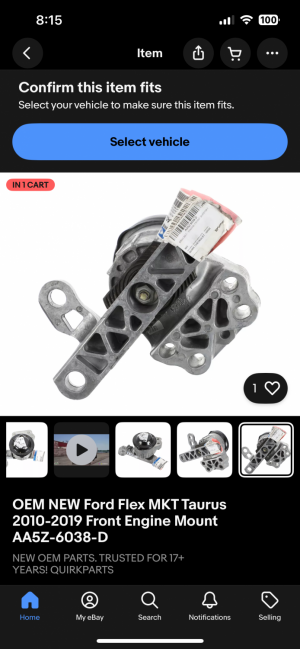

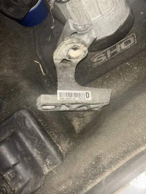

Yeah I’m trying my best to be. Valve covers were very sticky and the front cover comes off today finally. Also has anyone ever seen a motor mount do this? I had the floor jack under the engine and unbolted everything and it came out like this. Maybe this is that loud clunk I would hear over bumps. Definitely not safe to put it back in so time for another $100 and waiting some more on a new one. This car was in a bad enough wreck to total it years ago so maybe it cracked then. First pic is what it’s supposed to look like, second is what happened to mine.

sure it is, no personal experience however.... you found it.
