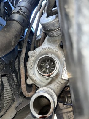

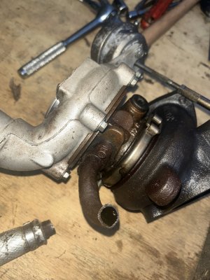

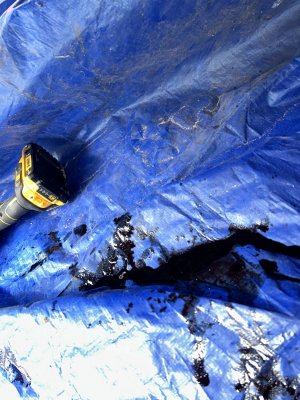

Here’s more carnage for you all, front turbo dumped oil everywhere and doesn’t spin freely anymore, and rear turbo has a ton of shaft play and chewed its own blades up. So now I’m going to be doing 2 turbos. I’m going to buy a new rear, and warranty the front one since it’s not even 5k miles and the seals blew. First picture is the front remanufactured OEM one again, second is all the oil it dumped, third is the rear OEM replacement turbo. The rear didn’t dump that much oil but it’s bad. Very bad. And my boost control solenoid had a crack in it so I’m buying a new one of those too!

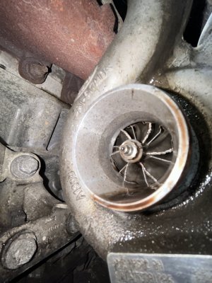

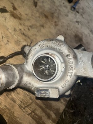

Well “new” front turbo is out, and the oil return line came with it since it rusted through. Gonna be sending it back on Monday and Rockauto is sending a replacement. Rear turbo is going to be ordered tonight with the axle seal kit and axle nut.

Rear turbo is out after a ton of fighting, shaft snapped just like the original front one. Thankfully that passenger axle was replaced shortly before I bought the vehicle so no need to replace it, but I did buy the new seal kit to make sure the PTU and trans fluids stay separate. Now let’s just hope the harbor freight jack stands hold up lol
