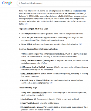

Referencing the above screenshot: Verified with a mechanical gauge, check. change oil, oil is full syn 5w30 Valvoline advanced, check. the throttle body would be a new one on me to correct an oil pressure issue but ill give it a try, it does surge at idle when the light is on. And the sensor and harness have been dealt with. But what really got me repeating another thread (with a twist) is the turbo screens. how hard are they to swap out? what do they look like? part numbers? I can not find a straight answer, I have seen an orifice tube style that goes in the block and a screen barrel style that goes in the output end of the turbo line, what do we have? both? I am basically ticking off every box that could possibly effect pressure without going to internal damage or weak pump. if it comes to that I might have to give it up

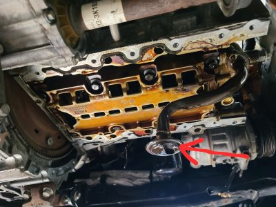

I scoped the pan and the pick up was clear, a gauge verified it was operating above the 7lb trigger so I disabled the switch all together.
