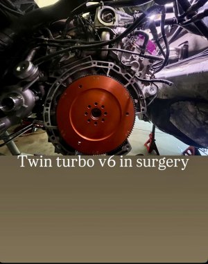

Got both turbos in and rear main seal, got on flex plate. Pending my transmission rebuild kit arrives in next few days I’ll get it all done up and back in. I do have a question does anyone know off the top of there head what size bolts go to the block that hold on the rear turbo support bracket? I have bracket and what I thought were correct bolts but they don’t seem to thread in the block entirely so somehow I mixed them up with something else. Any help is appreciated.
