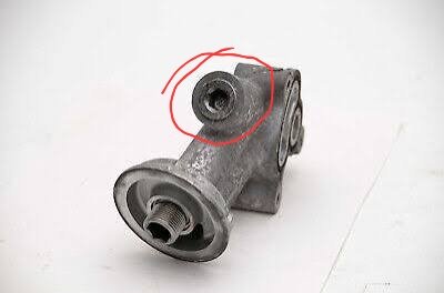

Talking about pulling this plug and replacing it with the adapter?

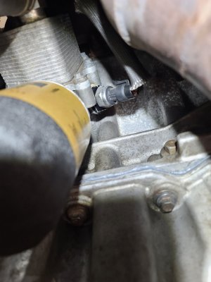

Yes but our adapters are a little different than that one. Here's a pic of mine. It's hard to get a wrench on it. Maybe a crows foot would work better but I cut a section out of a 1-1/8" socket to seat the adapter. It doesn't take much torque; you're just seating the o-ring. I also used some Permatex 59235 sealer. If you have catted DP's, it will be harder to reach.Sensor

So did you put the factory plug there or is that some kind of super low profile pressure sender that I cant seem to find lol. My main concern was the cats in that area since I still have mine, I think ill try the remote system since its on the way to my house and switch to this set up once I go catless. then again if I get bad readings I might have to finagle a way to make this way work sooner than later. about 2 years ago I was fighting with the light but my ear was telling me it was wrong, no clatter or knocking, smooth as silk. I cleaned the connector and replaced the sensor after a series of tests with a pressure gauge directly in the hole the sensor was in, I think hot used oil I got like 11lbs of pressure at idle. but now that the light is acting up again and I have the means to just have a gauge full time I entered this would be easy project. I have that adapter you suggested saved in my cart, I really appreciate the input

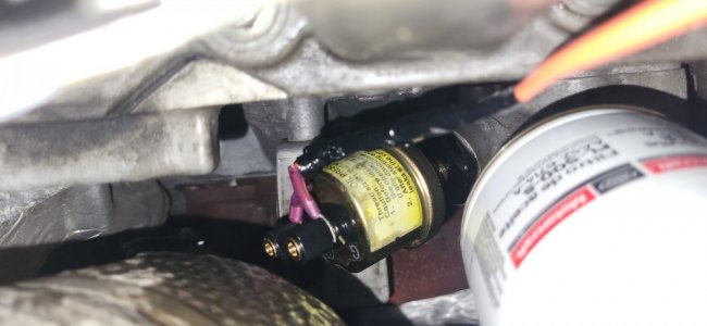

I used the sensor that came with the Glowshift GS-W704. Looks like a standard sensor to me. Plenty of room even with cats. Just hard to get to with the cat in place.

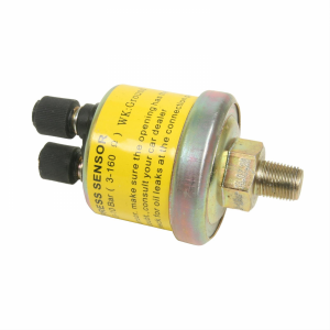

I got this golf ball, I too assumed the sensor would be more like what you have, but this thing came with my gauge.

Its an eye sore for sure, But if I google "oil pressure sending unit" I get that or OEM stuff, so I guess the question is difference in sensor and sending unit and will it work with my gauge. But, Glowshift had a remote mount kit (ironically for this type of sending unit) for $30, comes with fittings and 3' of braided stainless hose + bonus 3/4" clamp! Its my hope that pressure is pressure and I get accurate readings so I can put this project to bed finally. I miss driving my car and with the phantom issues it keeps having I like being able to see the essentials.

After a couple parts swaps it's finally working, thanks again @BradM for the adapter suggestion, worked perfectly. Little concerning how close the sender is to the cat but I read the gauge manual and it said I can use the other style sender just takes different wiring. So if it melts I'll swap it out.20251025 101439
