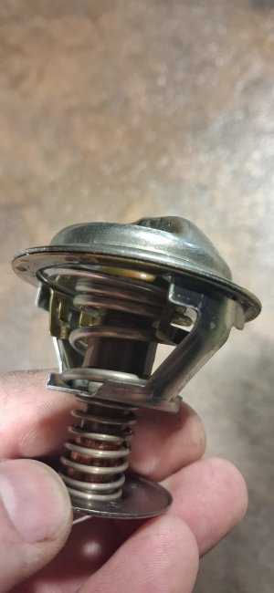

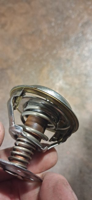

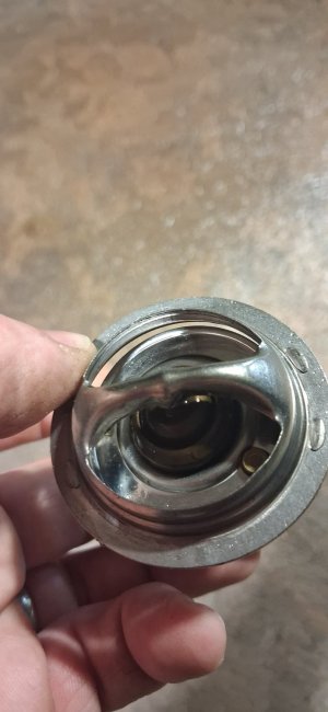

I may replace the cap to cover all my bases, but the culprit has been found. Thermostat appears to have jammed open somehow... never saw a failure like the first one, and never seen this either. In the middle of bleeding the system, too late to run a compressor, not sure how the ac pump would handle it, so going old school with a tire on a ramp holding the reservoir higher than the engine. Time will tell but it seems to me that this would do it. And when I say jammed i mean won't move at all. Went with a Gates this time, last one (pictured) was a MotoRad. Now the million dollar question assuming this is the fix.....do I feel dumb? Yes.

Congratulations! I too have never seen a thermostat do this. Is one side of it contacting the housing? How is it staying open? Crazy.
Sep 6, 2023
879
1,096
Florida
Just tack it to the list of quandries with this car. I threw it on the ground a few good times and pushed it around by hand and it won't budge, nothing appears bent either. No clue how it happened but thats a neat trick.
