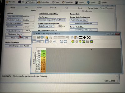

So tuning this car is to accurately command load. Boost is merely a byproduct. It’ll command boost all on its own to satisfy the torque request if its pressure limits are reasonable and calculated just above targets, it’ll use it. My math puts this car at 1.7-1.9 load all day. Just does it do it at 18 or 20+psi? This way I’m learning to command load and calculate the boost the car will need. So it’s always a load target first, boost target second. Boost target is what I build my spark strategy around for the fuel I’m using. The silent inverse torque clip set intentionally just above my load target ensures the car always has a safety fence.
It’s an incredibly satisfying loop. Tune, log and detail and take pics.

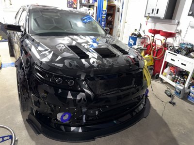

Car is ready. Clean, tuned, plenty of 93 in the fuel cell. After work it’s test time IMG 1472

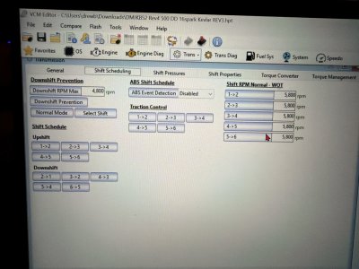

I lowered every WOT shift-start value another 50 rpm:IMG 9E75FE8E 26E0 45C1 BDC7 FE53674C8D58
These values tell the transmission when to begin shifting, not where the completed shift occurs. With the expected 300–500 rpm carry during clutch application, 5,800 should place the actual completed shifts close to the 6,200-rpm target while maintaining plenty of distance from the 6,600-rpm engine-speed limit.

• Driver Demand capped at 500 lb-ft
• Inverse Load clip limited to 2.15
• Desired TIP limited to 72.0 inHg absolute
• Spark limited to approximately 16°
• Turbo airflow protection limits raised conservatively instead of disabled
• Revised OSS modifier for improved low and mid pedal response

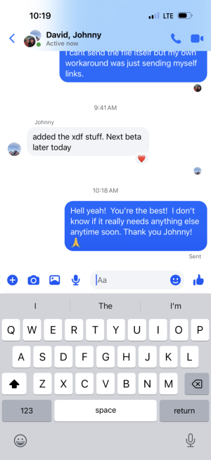

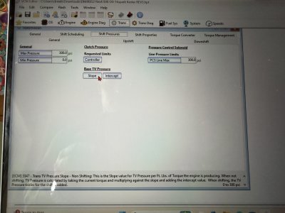

Later today Clutch ramp and static pressure definitions get added to the Green Oak OS! IMG 1656
My AI assistant searched and made that XDF file for Johnny. Pretty wild validation loop. Assistant looks through the raw A2L, finds the definitions and then writes its own XDF file? Then Johnny the HP Engineer permanently adds it? That’s bad ass
7,445
9,754
It is awesome, but that is how you get Skynet.

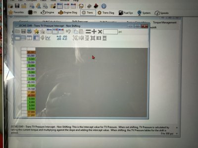

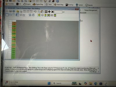

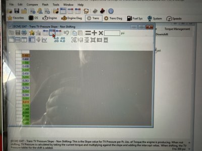

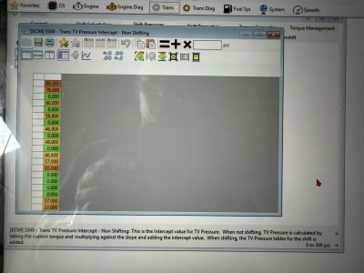

Wow. There it is.
IMG 1663The new Green Oak transmission definitions are now live in HP Tuners Beta.
The two big additions are:
• TV Pressure Slope – Non Shifting
• TV Pressure Intercept – Non Shifting
These define the base clutch holding pressure when the transmission is not actively shifting.
The logic is essentially:
TV Pressure = (Engine Torque × Slope) + Intercept
Then, during a shift, the shift-specific pressure tables are added on top of that base pressure.
That distinction matters because it separates two completely different jobs:
1. Static clutch holding capacity
2. Shift apply pressure during the handoff
The slope determines how much additional pressure is commanded as engine torque increases.
Here are my changed values compared to OEM as they were hidden in the tunes before I exposed them. OEM has a light violet background in the value using the compare file function:
IMG 1664IMG 1667IMG 1665IMG 1666Simple example:
If a clutch circuit has:
Slope = 0.60 psi per lb-ft
Intercept = 60 psi
At 400 lb-ft:
400 × 0.60 = 240 psi
240 + 60 = 300 psi base TV pressure
That is the pressure request used to hold the clutch once the gear is established.
The separate shift pressure and ramp tables then control how pressure is introduced during the actual clutch-to-clutch handoff.
This is why simply raising shift pressure or changing fill time is not the same as increasing established clutch capacity.
In my case, the Kevlar clutches appeared to need more static holding pressure at higher torque. The goal was to increase established holding capacity without deleting the factory shift timing, fill, offgoing-clutch, or protection logic.
That allowed us to treat the actual problem directly:
• Preserve the OEM shift choreography
• Preserve fill and timing logic
• Increase pressure as torque rises
• Increase established clutch holding capacity
• Avoid using aggressive shift pressure as a substitute for insufficient static pressure
These definitions came from the A2L, were rebuilt into an XDF for validation, and were then added by Johnny Powers to official Green Oak support.
Pretty wild seeing them in HP Tuners now.

One important nuance: the result is limited by the applicable pressure ceilings. In the editor, the overall displayed limit is 300 psi. Once both the OEM and modified equations reach that ceiling, increasing slope or intercept cannot command more than the cap. The improvement exists mainly in the torque range before saturation and in how quickly the calculated pressure reaches the ceiling.
We increased the non-shifting TV-pressure slope and intercept by approximately 20% on the relevant circuits. The slope is expressed as pressure added per unit of calculated engine torque; it is not a percentage of holding capacity. Raising both values increases established clutch pressure throughout the unsaturated portion of the operating range while retaining the OEM calculation and shift choreography.
