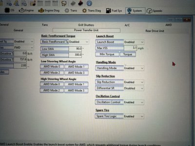

I think this is probably one of your best responses here. I don’t believe you have no clue at all what you’re talking about. Trying to warn me isn’t a bad thing.
From my perspective all I’ve had is this ‘10 SHO. It never seemed to really be a limited thing until of course the 13+ Tricore came around and everyone got like twice the definitions. I totally get why 2X the options automatically comes with 2X the capability assumption but I think it’s true. I’d agree 13+ is more capable bc it can technically be refined much further.
I just work with what I got and I don’t know what my OS is missing until I looked at my buddy Brendan’s file. I don’t even have an AWD tab in Systems like he does. He didn’t have the rear drive unit menu but his PTU menu was pretty big with a launch boost menu? Image
Do you have that? Have you made any edits or tested it?
You had me thinking maybe I was actually really missing some fuel definitions and honestly I probably am. Ryan hasn’t been smooth sailing, and over here it’s not all gravy.
I’m learning as I go but it’s really interesting in my stock OS WOT start/stop was set to 1,023 A/D count. That’s 5 volts. Also my stock manual fuel target was 1.0 lambda, enrichment was set to 90% throttle angle too with a .10 enrichment delay. That is crazy right even for a stock car? It’s true right that Ford has these cars going WOT with even a few degrees of knock retard as like a “business as usual, nothing to see here” vibe. Likes it’s normal? I remember hearing that years ago.
Like for early PE I learned that reducing the WOT start/stop to 599 is closer to 2.7 volts if I’m not mistaken, bc the TPS sensor probably maxes at 4.7 so that OEM setting essentially prevented PE in my experience. What worked for early PE and resetting KOM fairly easily with normal driving was

That’s why I’m really hooked on HPTuners. I can view what my calibration is and make edits. And can share it and compare files, how HP highlights what’s been edited in file comparisons is pretty awesome. I don’t think I can go back to getting a file and never know what’s in it.
