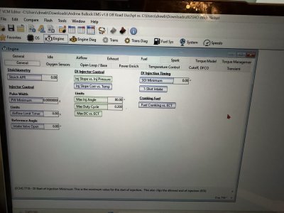

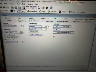

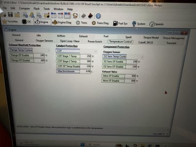

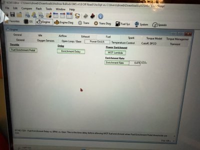

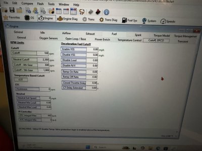

The car is obviously running scaled injectors today, so some form of injector characterization is occurring. Whether the exposed tables represent the complete injector model remains an open question.
As we’ve seen, what’s been previously released and defined is NOT the full list of definitions. Is it hardware limited or software limited. I’m leaning more HP software definition limited.
It could be a combination of your approach to scaling injectors is missing, while the ability to scale them remains. This is an interesting one bc obviously if they weren’t scaled my fuel data would be atrocious. But I think there likely is more to find so I reached out to Johnny Powers and he said he would take a look.

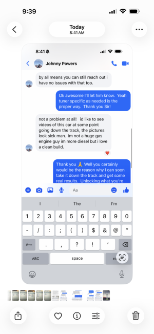

He told me to let Ryan know he can reach out directly. He seemed genuinely interested in the car and wants to see it go down the track lol. That’s pretty cool the engineer on my OS is interested in seeing it perform! IMG 0598
So I can show you all the channels Ryan has edited in fueling so far. And if you want to see a data log let me know. I don’t care about being right while I also don’t want to be wrong. I just want to know what reality is.
Highlighted are edited. IMG 0599IMG 0600IMG 0601IMG 0602IMG 0603
If I didn’t show the fuel screen it’s bc it’s not edited at this time.
Now that we have direct contact with Ford Engineering at HP, we can look for more missing channels as needed and get a hard, yes/no and get them added.
