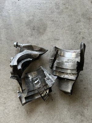

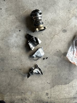

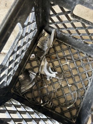

Water pumps not a bad job time consuming but pretty easy, let me know I did it prob 3 months back and have ample video of it and photos. The noise you hear, is it coming from driver side floor board area starts at about 34-40 mph and carries on the faster u go the louder it gets? From my experience it is 1 of 2 things. Your rear drive shaft is going bad and having crazy resistance on the PTU ****** to turn it and the extra stress begins to wear out the output bearing. Or the internals of PTU are shot, drain fluid and check for greyish paste or greyish oil when drained. Some metal is ok but big chuck or solid grey color or burnt smell are all signs. This just happened to me recently and I couldn’t figure it out so I kept driving 3 months with the whine until one night I had enough and full sent it off the line. Photos are end result.

Soooo,,, what was the cause and any lesson learned you might share so our SHO's do not grenade themselves?
I have learned quite a bit during this process. I also did a lot of while I’m in there’s too. But I had a few problems I think all contributed to this, of course this is all speculation as it’s real hard to pinpoint an exact thing but I think it all contributed to make one big problem. I will list problems found along the way and how or why I think it was a contributing factor.
1.) bent rear rim
2.) shot carrier baring on drive shaft.
3.) leak from PTU seals on passenger side
4.)grinding into PTU output side of housing internally.
So during my adventure I found I had a bent rim which caused a good little vibration starting at 70 mph and dying off around 85mph or higher but majority of my driving is avg 80 on interstate. This caused me to always have a slight shake traveling down to the drive shaft which caused more stress on the carrier bearing and wore it out. This made it more difficult to spin in general causing more stress on the out put bearing of the PTU. This eventually led to a small vibration from driveshaft to PTU which began slowly grinding into the inside of the case of the PTU. It wore the bearing out causing more resistance in general and eventually wore the PTU case down on the out put side and got it hot and broke it right off. I also think with it leaking just a tad but faithfully it would have been less fluid than I’d like which helped it heat up faster wearing internals out in general.hard to know exact amount but I had changed fluid within 3 weeks. Fluid was like it should be but smelled Burnt.
