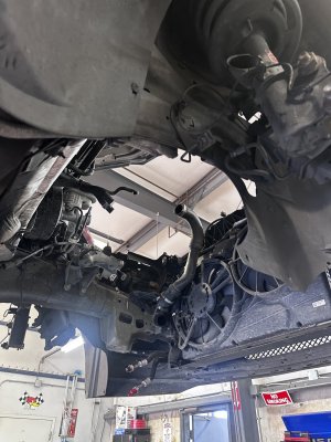

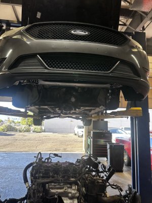

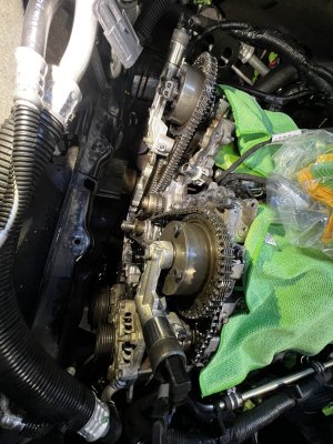

A shop pulled my engine out, get a new oil pump since you’re there. It looked like a chore, I had a warranty so I was alright

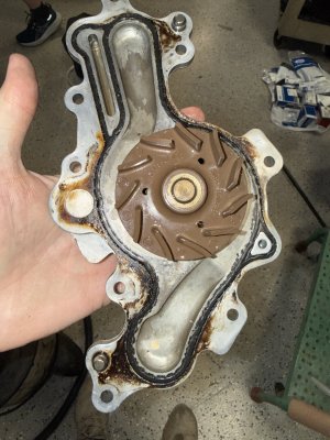

3) I was hoping for a smoking gun in the water pump gasket, but outside some smudging near the weep, I am not sure I see it. I didnt really see weep hole leakage but I think I caught the pump very early. This is the old pump, anyone see any weirdness? It's interesting that on the old pump the turbine was made of plastic, but the new one is made of metal. I'm guessing this was a reliability update?

The later crankshafts use a long bolt. You need to get a matching bolt to the original. These are the two bolts I know of. There may be more.
1783219615779
1783219658324
Crank gear is cheap. Change it.
Probably, new phasers rattle because they have never been pressurized with oil. F-150 phasers are different and not interchangeable.
Careful when cleaning the block surface that you don't let debris get into the oil pan.
