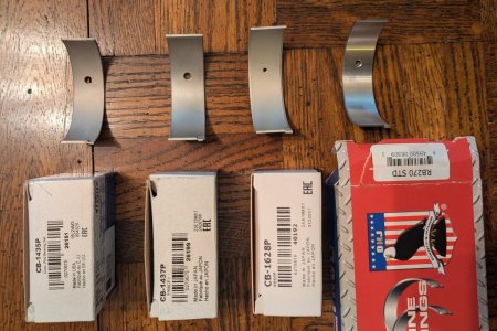

Here are the 3 contenders that fit easily in the bore so far.
The Acura (rb270 std) fit with the least modification, though they are a bit more narrow. With my spare crank it seems like .25's would be better as the oil clearance is near the max allowable.
1628P has a tang that's too large / needs filing, and the oil hole is TINY
1437P fit great but also have a tang that's too large and needs filing on the back side. I did this with a hand file on the bearing seen here. It took about 20m, but it's not perfectly round when installed. (probably needs more filing)

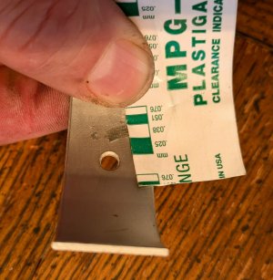

Unsure :/. Still need to check:
- Q45 bearings VK45DE
- Accura .25s (for better clearance maybe?)
The CB-1437p is my favorite, if you have the tools to measure roundness / clearance and the patience to carefully file the tang. I have been filing some down by hand and they plastigauge between 0.038 and 0.051 which is great, and they're almost perfectly round installed according to the mic. (I was worried they may bow out a bit where I filed the tang). They also fit much tighter in the bore which I prefer.PXL 20250408 132322410

Updates: I went with the custom filed Toyota 1437p, plastgauge was just over 0.038mm on the car.
The 1 Acura I fitted was closer to 0.076mm+ and I could wiggle the rod on the crank with my hand after torquing them down which didn't seem ideal.
Filled it up with oil yesterday after letting the rtv set over night, and started right up with no knocking or strange noises or anything. I let it warm up and all things appeared normal.
I need to finish installing the y pipe and oil pressure gauge before I really take it for a drive, but initial review: seems fine?
I don't think I would use these if I didn't have a spare rod to fit/file these with on the bench. Having a cap to mark and file to helped tremendously, doing it while the car was all taken apart would have been pretty annoying imho.
