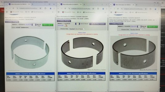

another possible option
I downloaded the taiho catalog and compared the sizes. But then I found 3 std sets.

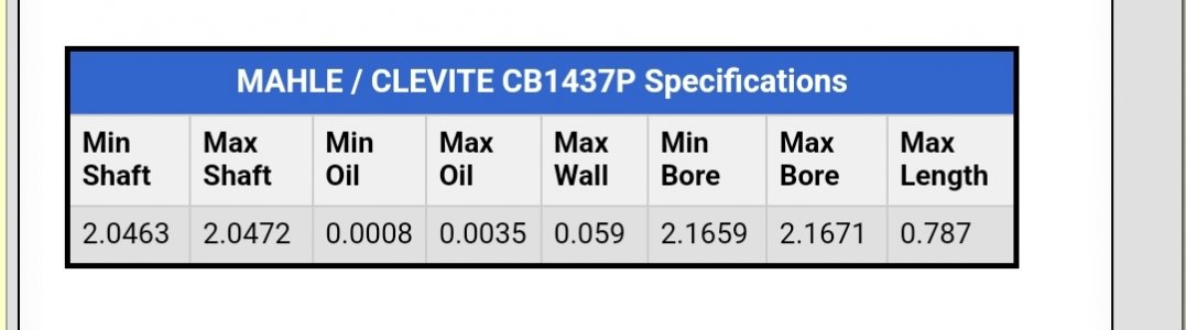

Those do look very close!
I ordered a
CB-1437p (1989 TOYOTA SUPRA 3.0L L6) -- oddly my Orielly has a set of these? Best selling car in america for a decade: Nothing. But a toyota supra? YEP WE GOT IT! LOL
ITM 6B9521-STD (1988 ACURA LEGEND 2.7L V6) -- I couldn't find any of the Clevite, but these were cheap on rockauto
ITM 6B9518-STD (1994 TOYOTA 4RUNNER 3.0L V6) -- same as above
I'll photograph them, and test them for fitment with plastigauge on a 3,2 rod/crank I have in the parts shed in cylinder position 2

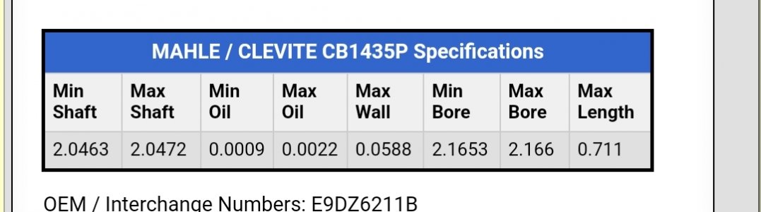

According to the manual we are going for:
0.024-0.056mm desired
0.08 allowable

Looking at the numbers of all three I personally think the better option would be the Acura bearings. Set of 6 on RA for $24.

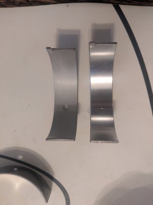

The pile of bearings I ordered arrived today, and I went digging through the shed and found a set of 3.2 pistons to test with and a set of 6 CB-1435p (thank the gods).
TLDR: the Supra bearings (CB-1437p) seem to be the best bet (but some dremelling required of the tangs as they're too wide as seen in hte first picture) but these are extremely close. I haven't tested with plastigauge on a crank yet, but these are the closest to an OE fit of the bearings In the second picture, Supra on the Left, 1435P on the right.

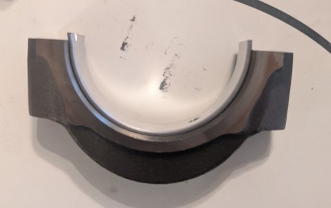

Below is the TM 6B9518-STD (1994 TOYOTA 4RUNNER 3.0L V6). these are narrower than factory and a bit too long, they could work if you're brave enough to shorten them. :oogle:
PXL 20250126 231313039PXL 20250126 231452439MP
The second picture is 1435P on the left and Toyota on the right.
Hope that helps, lemme know if you want any other data/pics on these.

That's odd that the Acura bearing came out so small when the specs match up almost identical to the 1435p. The only thing that should vary is it should have been slightly narrower compared to the SHO bearing just like the Supra bearing is slightly wider. Those were really the only specs that were off from the three. I wonder if that Acura bearing is misboxed or mislabeled.
