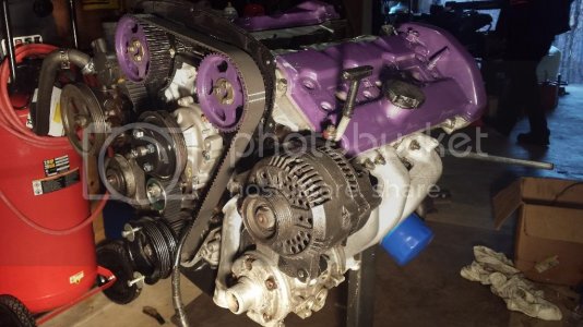

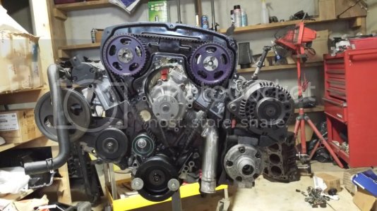

So made some progress today. All new valve stem seals, water pump installed, put the motor in time, and installed a few other items. coming along pretty nicely.
Also picked me up a Quaife tranny.

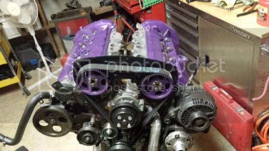

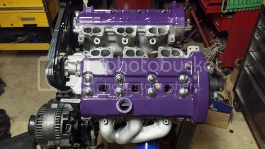

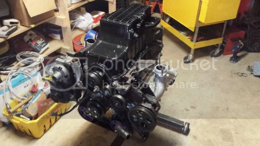

Thank you very much for the support fellas. Updating the thread because tonight I was able to finish the valve adjustments and popped the valve covers on.
All the intake valves were .007-.008 and all exhaust were .010-.011
Just ordered ARP flywheel and ARP pressure plate bolts as well as SHOsource's Steel Billet flywheel yesterday.
Anyway, here is the pics.

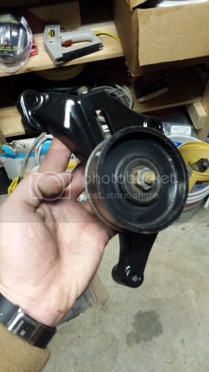

Also got some of the brackets painted. look NEW.
