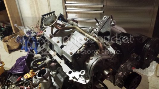

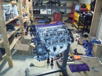

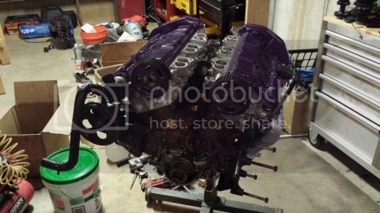

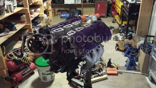

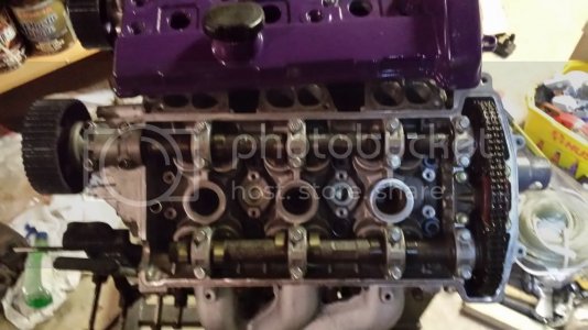

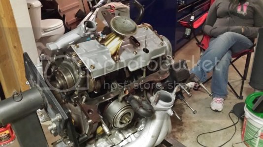

So i have not updated for a while but the motor is coming along pretty smoothly. Got the heads bolted on, cams installed, bottom end all assembled, half of the valves are adjusted but for the other half im going to need some pretty odd sized shims. Also got some accessories bolted on and finally gutted the AC compressor. Waiting on a timing tensioner stud, water pump, timing belt, timing belt tensioner, valve cover gaskets, valve cover grommets, oil pickup tube gasket and the oil cooler to block gasket. All ordered from www.SHOsouce.com. :thumb:
20131222 014835 zpsbd6abaf4
20131222 014858 zpsba55fa86
20131222 014919 zps9b8e8253
20131228 230128 zps065aeae3
20131228 230141 zpsdfcbacc4
FB IMG 13885524640434516 zpscaa52f01
