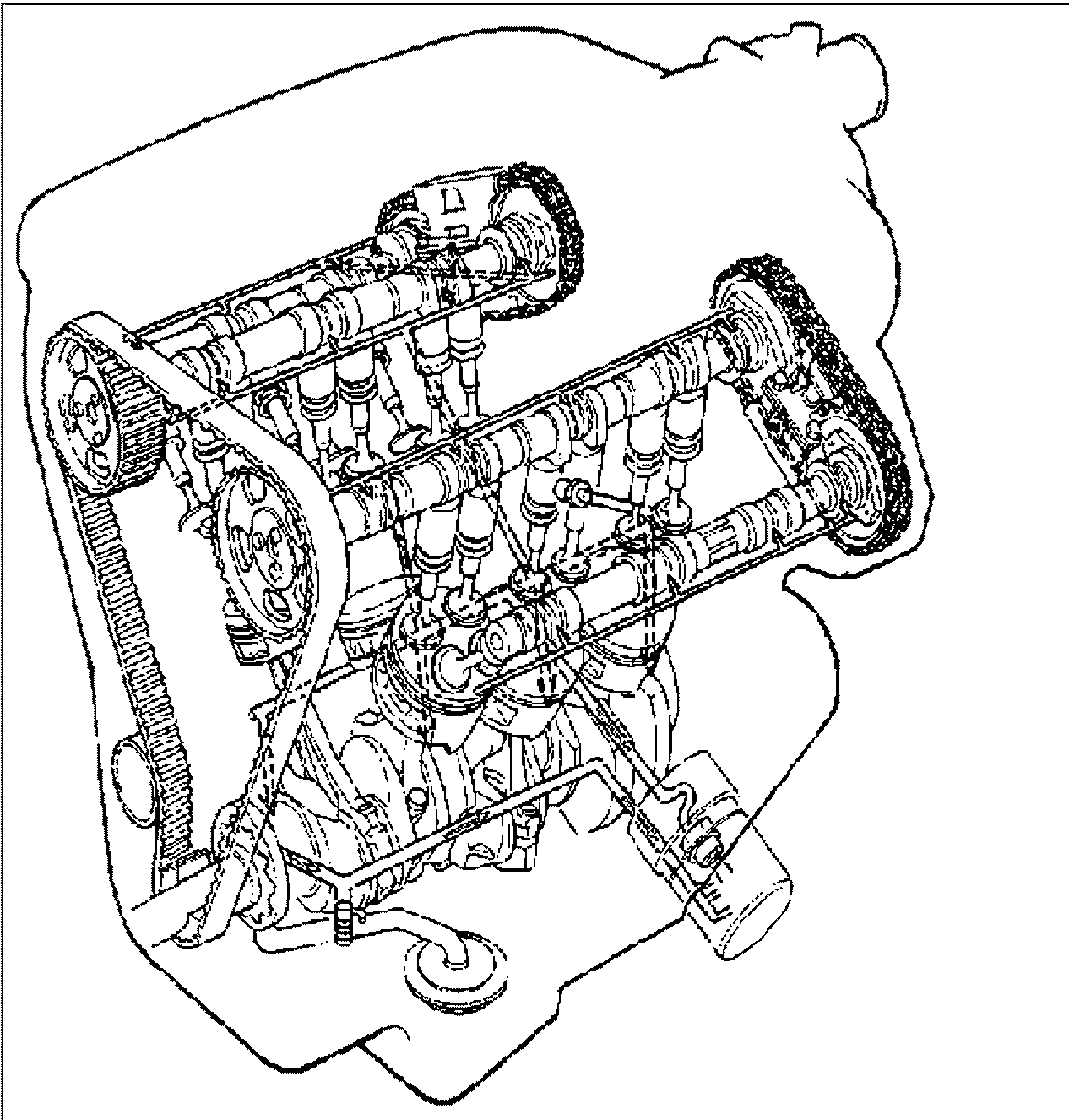

FWIW here is the drawing of the V6 oil flow.
dont wanna be rude but does anyone else have a clearer picture or even possibly color the oil flow for me because i cant read this picture very well

Look here. Go to page 36 of 129 in Adobe Reader, bottom of the page. Copy the link for future reference, as it tends to "disappear" here once posted, for obvious reasons.
