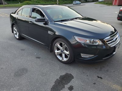

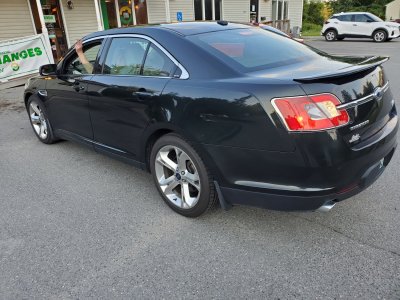

A big thank you to everyone here who had contributed to the conversation/ discussion! A second thank you for the pictures and videos. It's been very helpful in the decision making process and I've learned a lot from you all. The build is going well thus far. 3 weeks ago I got started with a GH tune along with the package goodies. Went well minus a map sensor in the wrong place which was a very easy correction lol. Also got my AD trans mounts in that same day. Yesterday, me a my buddy got the new GH intercooler swapped in. That went beautifully and woke up the car even more . I already have ppe catted down pipes ordered as well as a xdi35 hpfp on the way which are 4-5 weeks out yet and I am nearly drooling in anticipation! I also purchased a jlt catch can which I plan to install with a epp cai but have not yet recieved. Got it washed up yesterday so enjoy a couple pics guys!
