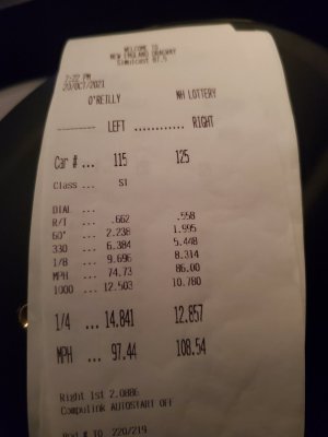

Thanks! It hasn't seemed that quick, but in the grand scheme you're right lol. Looking forward to downpipes to get the full experience, not that it isn't already a blast to drive. Not sure meth will get finished in time for next week's track day though.

That's a decent time for how high your 60' is.
Yeah buddy! I'm looking forward to next season :) That was with a half tank of pump 93(actually 92). I didn't lower my tire pressure, obviously didn't load my e30 tune yet, haven't installed my alky control meth kit, and I intend to have a set of nittos to run for spring as well. I think I'll easily hit low 12s, maybe push high 11s :thumb:

Also if you account for reaction time vs anticipation of the light that was about a 12.5

Sadly that is not how it works. When the light turns green the reaction time clock starts. The actual timer clock for your ET does not start until your tires leave the beams, when that happens is when the ET timer starts. You could have sat there for 20 seconds and it would not effect your ET as long as your car doesn't move.

But yes about a 12.5 with a 1.7 60ft, which is definitely doable for sure. Lose another 40lbs of fuel too and maybe as the car sits it’s capable of a 12.4.
This I did not know, but thank you for filling me in :)
