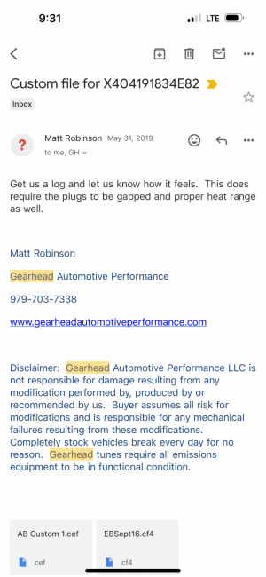

In direct contrast a tune sent to me from GH when I bought their Gen3 turbos and intercooler. Didn’t ask what I had for mods or anything. I don’t have the slightest clue what this tune would be commanding before trying it. Of which I never did. IMG 2841

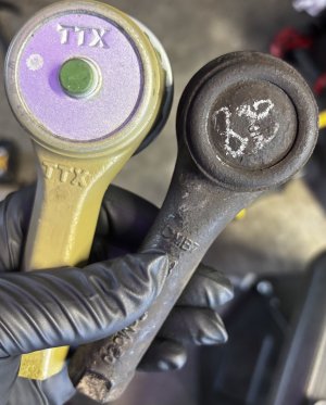

Did the shocks/struts, and rear LCAs first, and gave it some time (~500mi) to settle before doing the rest of the work. Everything is OEM except for the front LCAs, and tie rod ends. Giving the mevotech TTX a shot with those. If they work out I may replace the front and rear endlinks with them as well since the ball joints on the TTX stuff are…beefy (and greasable).

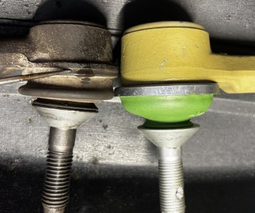

To illustrate beefiness:
IMG 4557
IMG 4556
Everything came out, and went in pretty smoothly. I wasn’t looking forward to the rear upper control arms because of those expertly oriented forward bolts (thanks FoMoCo), but it wasn’t too bad. Just loosened the subframe enough to get clearance by prying down on it a little. Honestly the biggest PITA was getting the new tie rod boots seated on the rack. Those bastards about took my damn lunch money lol.

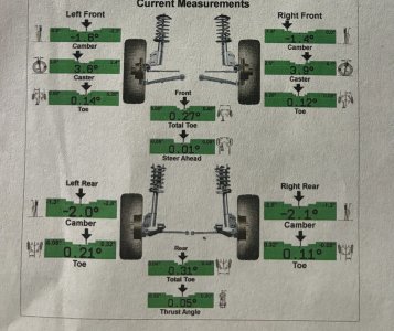

Had it lined up the other day, and after what settling has occurred, this is where it’s sitting WITHOUT the camber bolts installed in the rear, and with the arrows on the mounts pointed outboard:
IMG 4566
Camber is sitting pretty good as is. I think it’ll work well with how heavy the car is/how it gets driven. The toe in should complement the camber. A majority of my driving takes place on the Northwest Indiana autobahn (aka the toll road) these days so that translates to higher average speeds, and a fair amount of twists for Indiana. Though as we all know toe can be a little tricker to dial in from vehicle to vehicle due to variables. I bumped the cold psi on the tires to 37, and have pushed it while straight, and through various twisties. Everything “feels right” while driving under various conditions, so I’ll just see what the tires look like at the next oil change to get a better sense if I need to tweak anything.

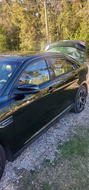

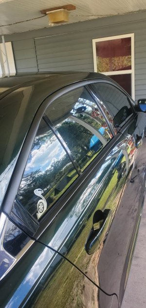

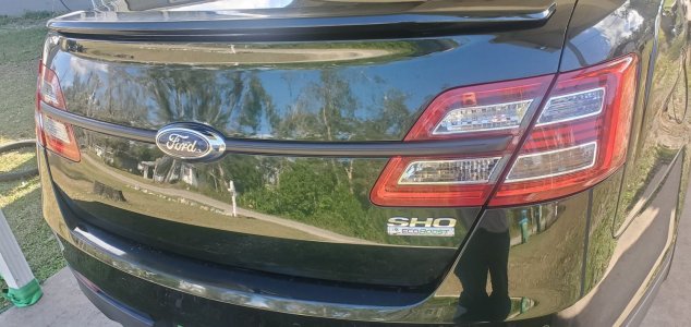

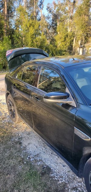

Full detail and started the chrome delete process. The weather was not in my favor. Cold and rainy for the wash and warm and windy for vinyl and plasti dip. Only day I had to do it so I tried, might start over another day. I dipped the trunklid bar and vinyled the window trim. Ran out of vinyl so only one side is (almost) done lol20241231 131054

Anyone else's window trim loose and crooked? Honestly you can't tell from a distance but if you're close enough to see bubbles in the vinyl you can see they're raised in areas and won't "click" back down. Annoying

Mine dis the same..... Unfortunately
