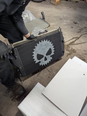

Water pump/timing chain/tensioners/guides/cam phaser/PCV valve done last week at 65k miles. Timing cover had a decent oil leak so that's why it was done a bit early, took the chance to do everything while re-sealing that. As a treat to myself had them throw in the GH intercooler while everything was apart. Car feels very healthy now. Like many others here, performance is about the same but at 4-5 PSI less boost, and it drops 20 degrees celsius like nothing when I hit the gas. Wallet took a big hit though lol.

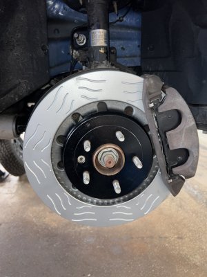

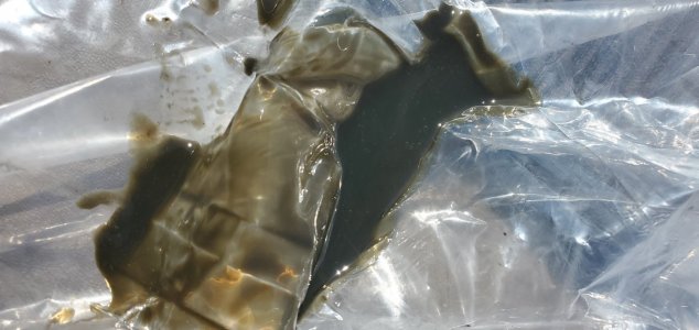

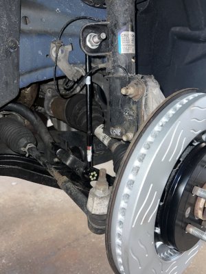

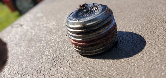

Trying to stop my noises. Brake squeal, clunking from the rear, and a weird intermittent grinding sloshing noise ive posted about previously. I replaced All 4 brakes and rotors, front axles and rear sway bar links. Tranny drain and fill and ptu drain and fill. Trans looked great for 20k miles, like new almost.
The ptu was a different story, seems like a lot of metal on the plug for 20k and the LWSP once a nice blue is dark brown, opinions on my PTU health? Thinking this might have been my noise but I'm still adding fluid as of the time of this post. Just took a break when I saw this.

Thata not much accumulation. After all that work is it making noises still?
Sep 6, 2023
871
1,081
Florida
seemed like a lot for 20k, close to what was on it when I did it the first time and that was atleast 30k+ since thats how long I owned it for. still making noise though, going to check my intermediate shaft and rear driveshaft to double check none of those are to blame, but it only does it when it warms up after driving for a while.
