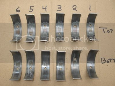

Coming home from work last Wednesday I was sitting in some heavy traffic. I thought I noticed the oil light flicker ever so slightly. The first words that came out of my mouth was "I know that was the Battery Light"!! I turned on the dome light to see which light it was and sure enough it was the Oil Light, then I said "OH CENSORED!!!" Well I managed to get it the next 12 miles home without anymore flickering and no knock. Thursday I ordered new rod bearings and let the SHO sit till Sunday when I could make time to change. After I pulled them out I was surprised. They aren't as bad compared to others I have seen. The SHO is back on the road and healthy again.
Here is what they looked like:

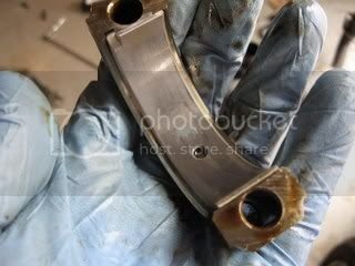

We should make this a rod bearing picture thread, since you have a nice shot of your bearings and mileage. Here is my contribution:
196K, ATX, rod knock (can you guess which bearing?) and oil light flickering.
^The motor lives on with fresh bearings
160K, MTX, ran fine
Nice and smooth now!

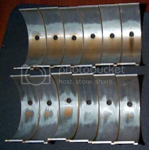

Here's mine after 185K using Mobil 1. They were is pretty decent shape, never any oil light indications.
