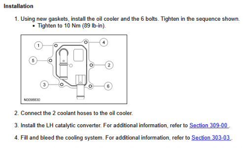

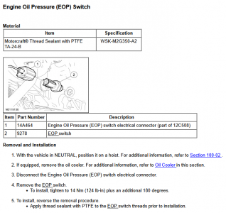

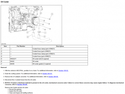

Likely the oil pressure sensor is going bad. It is simply an on/off switch. It closes at @5psi. Possibly can be changed without removing the oil cooler.
