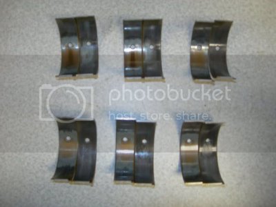

here is a set with 167000 miles on them
Bearings
these were starting to show copper, but no damage, they were in need of replacing though.

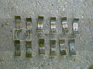

140,000 miles...these made noise on cold startups. When I pulled the oil pan, little stringy clumps of RTV sealant were partially clogging the pickup screen. I changed them out in July and have put 8000 miles on my car since then with no problems whatsoever.
By the way...whats the argument?

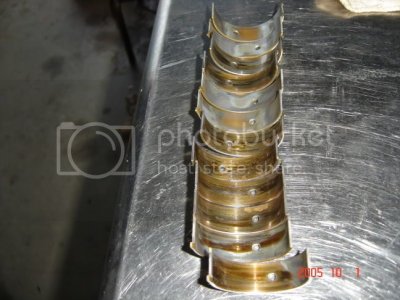

Bearings @ 132k. 3k intervals, stock bearings. The car was driven by a woman before i got it, so, more than likely there was a decent amount of luggin' going on.
Only got a slight flicker of the oil light when rpm's dropped below 500-600. Other than that, no sign what so ever.
