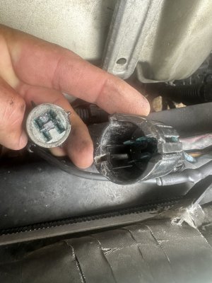

The fans also turn on as part of either the koer or koeo test (don't recall which any more). That is the best way to test because that tells you if all of the control and power side stuff works. Then the only thing that is left is whether the coolant temp sensor works or not, and there will be a code if it doesn't.
