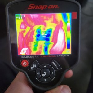

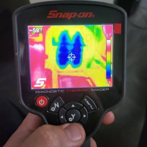

Deezuz
Dec 21, 2019
235
139
Indiana
My seats. You can see the passenger seat is by far way better thanks to Nobody ever sitting in it... I agreed the compacting of the foam is probably the issue.
