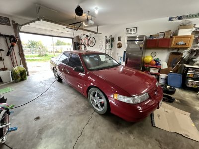

Quick backstory, received ‘93 MTX non running, knew it wasn’t getting fuel, suspected fuel pump.
IMG 7521
Got SHO1 shoved into the garage and confirmed no fuel at the rail, heard (what I thought) was the pump screaming at key turn to prime, and the inertia switch was good. Already had a pump on the bench so got after it. Car is astoundingly clean underneath, zero rust. Amazing and unheard of in northwest Indiana. I can get use to working on Cali cars. Little tight with subframe connectors but got it out with very few arguments. When I say clean I mean clean. Found the tank build sheet still attached to the top of the tank. IMG 7525

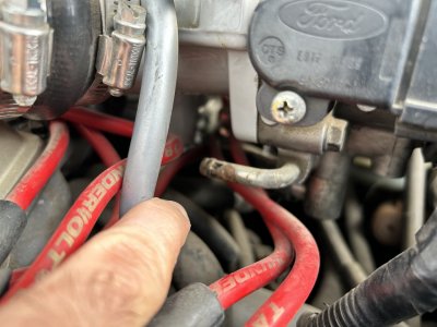

I did notice a missing line on the bottom of the throttle body. Looked at the running parts car and it was the same. Any idea where this is supposed to go?

a small coolant hose connects to that port, there are pictures of it on a members link. let me find it

here is a discussion of what that hose is
Well that explains it. Guess that’s a reasonable mod for a desert car.

That is a coolant line for the throttle body (to warm it up in the colder months and improve drivability). Many people delete those 2 connections (the in and out of the throttle body). Yours might be deleted and capped down near the thermostat.
