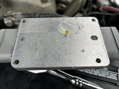

Had limited time to play so I didn’t test the DIS yet but wanted to at least confirm DIS/MAF as the culprits for at least the major issues. So for now, I swapped in the DIS from the second car. 100% it was dielectric grease that was used. IMG 7608
IMG 7610
Made the swap, WITH HEAT SINK COMPOUND! Then also robbed the OEM airbox, piping, and MAF and crudely plumbed that up to the throttle body.

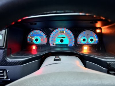

Fingers crossed, I fired it up. Gave it a few seconds to get the juices flowing and cracked the throttle, quick response, no hesitation, even sounded stronger. Said ok, I’m sending it. Pulled out and it was 100% a different car, ran great, responsive, peppy. The downside, CEL still on, gears feel kind of crunchy to jam into, and the tach works but it’s still slow and blocky in its movements. Overall I can’t complain with the amount of effort, how far it’s come from non running to drivable.
IMG 7612
Crappy pic, but I dig the gauges.

I had a tach that didn't make sense, it was always reading high by 1.5k rpms. Once I verified the cam position sensor was good, I swapped out the cluster and fixed it.
Glad the big 80mm MAF is out and DIS is working right. I assume you reset the ECU by pulling the battery? Pull the new codes and let us know what they are.
Did, and will do.
