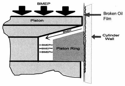

184815 cylinder break in diagram

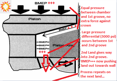

Piston rings seal by combustion chamber pressure getting between the ring and piston, excerting outward force. In the event of knock or pre-ignition, this is what happens:
1637358106936
Detonation (knock) occurs after spark, where the pressure wave of the flame front becomes great enough for fuel to spontaneously explode. It can happen anywhere in the chamber.
Preignition happens before spark, when some component becomes hot enough to cause the charge to auto-ignite while the piston is still on the upstro.ke. Can originate at an overheated ground strap, hot exhaust valve, glowing carbon deposits, etc...
LSPI (low speed preignition) is generally or most stated to be caused by oil droplets being scraped into the combustion chamber and sufficiently lowering the octane to cause compression ignition (dieseling). When you think about where that oil is coming from, it seems probable that these unhappy little accidents may even begin within the ring groove itself.
In any case, all of them cause tremendous pressure spikes that crunch, melt, or twist things in a hurry.

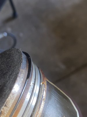

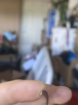

the upper ring ends are shiny/plain metal, no coating like there is on the lower compression ring.
haps are smaller because i didn’t center the rings with the piston first time. and yes my piston ring is very thin, not sure what spec is.
seeing this, LSPI makes sense. considering i was sucking excess oil into my intake.
ring end was stuck in the groove horizontally, like in the picture.
ring end looks similar to wall edge of ring
The running surface of the rings wearing is kinda what they're supposed to happen, and obv. if the rings were gap filed then there wouldn't be a coating there either. What you don't want is an extremely polished appearance on the ends, that would suggest closed gap. But also remember that this car was driven however many miles with a compromised piston and excessive heat passing through those rings, so who knows if anything you see is a symptom of that. Any signs of pitting or microwelding on the rings or the lands? Was there some piece of debris wedging the ring into place?
Your top ring should be like .040 thick. When you measure something you really need to have it spotlessly clean. Your measurements make no sense to me so I'm going to assume a bunch of **** in the grooves still.

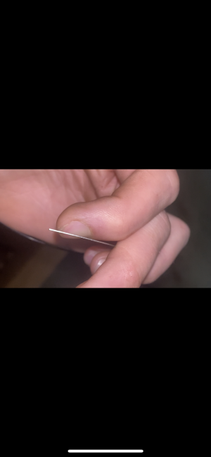

no putting or micro welding, no signs of debris holding ring. not sure why it was stuck, maybe some carbon? there is a little in the groove. piston is clean, ring is .017” thick. my math checks out.
.017" is a razor blade. Literally, I tossed one of those cheapo Harbor Freight breakaway blades in my caliper and it was .0165". Chilton shows factory rings at .046". JE specs .040" for their pistons. How does over 60% of a piston ring just vanish? Also you said:
upper ring to groove clearance - .043
upper ring groove width - .051
Groove width minus groove clearance = ring width, so .051" - .043" = .008" ring width...
-or -
.051" groove - .017" ring = .034" RTG clearance...
-or-
.017" ring + .043" RTG = .060" groove...
Your measurements seem irratic and totally unreliable. But who am I to question the math of the most qualified mechanic to ever own an SHO? :bowrofl:
