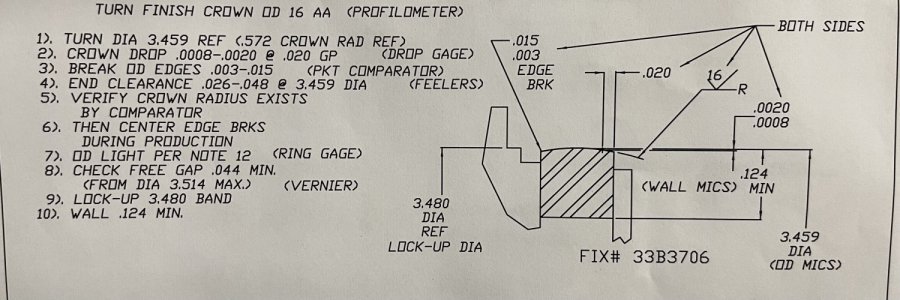

Its what i do everyday as i am hands on instead of in an office, as i am also a machinist. Aerospace is way more advanced then simple internal combustion engine work.
Inconel crowned od sealing rings for Pratt, there is even a picture of the stealth which i also still design and make parts for…

I have parts on the James Webb space satellite, and on Curiosity Mars rover. I usually machine Titanium, carbon and inconel within .00002-.00005 tolerance. With flatness specs down to .00001 (millionth)
Also have aero test rigs. Design a part, go out and make it, and then install it into a test rig to prove it out. Oh how its a nightmare of a process. Cant have a part go out bad, fighter jets cant just pull over if an engine fails. Good thing they have ejecto seats
