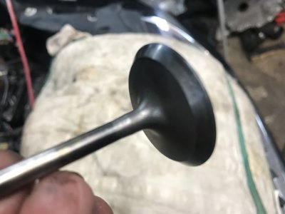

351Blueblood
Jan 5, 2018
42
23

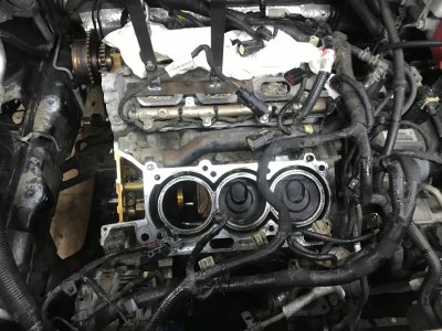

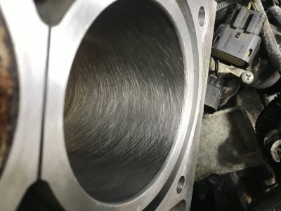

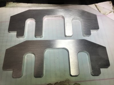

Yes I removed cams. I also pulled all valves to super clean ports and valves. I ball honed it in car. Went 11.9 couple days ago.

I have more then one MKS and did work on both. That's why I made cam lock tools. Plus I used it on the back head that I didn't remove so nothing move.

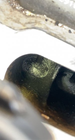

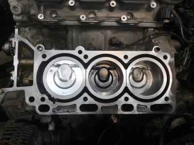

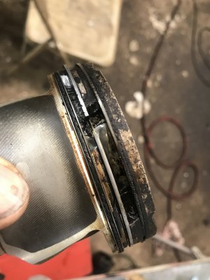

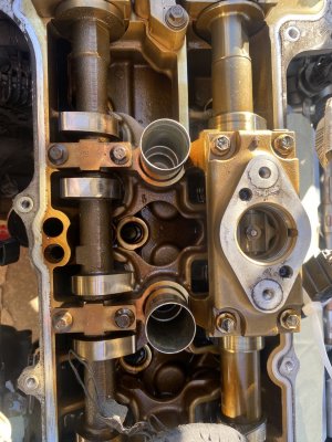

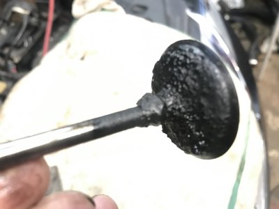

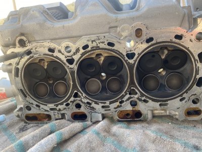

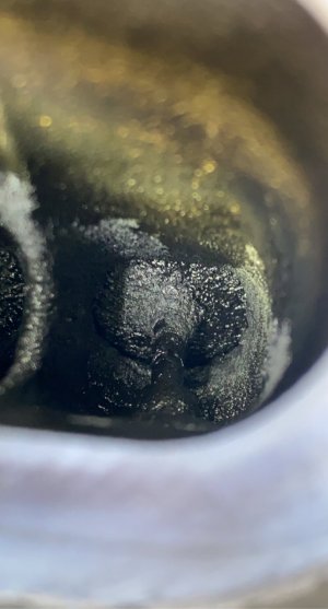

so i got my head off today, hopefully piston will come out tmrw. i do have a bit of an issue, piston 5 ( being removed) is at tdc. it should be bottom dead for removal. i can’t turn my crank bc my timing chain is off. not sure if i’ll be able to reach my rod bolts. looking at my piston head though it seems fine. no different from the others. can’t see cylinder walls but pictures below. timing chain was very loose but didn’t seem to be off.
