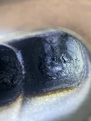

so heres another valve picture, these are covered. any tips on cleaning them?

DI without extra external injectors are gnarly.
I can't even make out the valve in that pic. Are you taking the valves out or leaving them in the head? If not removing, how accessable are they to getting an abrasive tool on them without hitting seals?

didn’t plan on removing them, how involved is the process? i will if it’s worth it, however the rear bank wont be getting cleaned.
