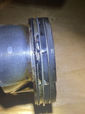

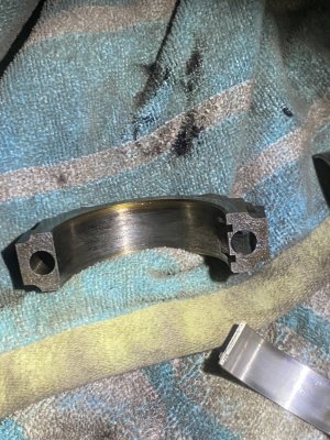

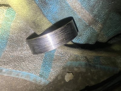

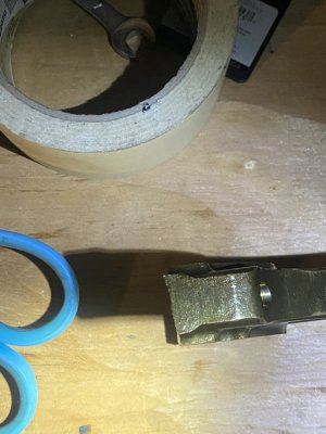

so chunks of my piston are just missing. also not sure if rod caps, section that mates with rod, should be flat? the surface is jagged. rod bearings are scratched all way around.
i’m terrified i damaged something though, didn’t know main cap support brace had a bolt pattern for removal. should i replace the brace or just bolts?

The rod caps are "cracked" off the main beam of rod from factory. Told ya your piston would be smoked. When I ordered my piston is did not come with wrist pin and C clips. You need to make sure you didn't spin a rod bearing there. If you did rod is junk. I can kinda see bearing tab on one shell in pic, Make sure bearing tabs look 100% and not knocked down like if bearing spun in rod.

Have you checked the oil pan and pump pickup screen for little pieces? Have you gone through the oil to see if there are particulates that are visible? Also get a good look at the rod bearing journals on the crankshaft? May or may not need a little polishing if you can feel scoring with fingernail.

no metal in oil and rod journals look fine

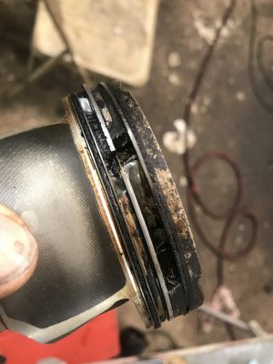

what would cause this? you had the same problem right? it seems weird for the piston to fall apart

Dude it just happens to these engines. Most likely butting ring ends. The ring end gaps are really tight on these,

butting ring ends? as in rings sticking to piston?
also not sure if i should bore my cylinder or not, will definitely need a ball hone but scratches are very minor. fingernail catches them but they’re smaller than a hair.

Lack of ENOUGH ring end gap under boost and heat makes ring gaps meet and then ring expands even more popping the piston ring lands. I bought my ball hone off flea bay.
