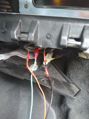

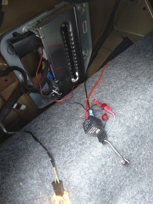

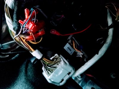

She was at the dealer for five days I got her back at 5pm, they did catch that it had been a modified so I was called in for an interrogation because they found my meth wiring hiding under cowl.
All returned to stock before i dropped it off, they confirmed all my new parts and after 4 techs, working together they were at a loss. They even went through a quarter of a tank trying to find the issue, They 2 Confirmed all new plugs, coils, O2s, I Decided to run a complete list of PID in forscan did the whole lot, and all it showed no fault with any of those parts. Before I gave to dealer. Forscan is a great software, a lifesaver for Fords. They called me Thursday and stated that solution unsolved we might have to admit defeat. On a hunch I stated my 2013 interceptor Has a bad pcm, which fried it's board after a bad misfire which made car go haywire but never a code for PCM. On last effort to try not to get car back still broke, I brought up how years ago I had a pcm/ECM burn a board, and no codes, happened after a bad misfire. I thought no way could out of three Taurus's I had two PCM go bad after a bad misfire. As a last ditch effort I asked them to just replace it, what else it could be happen this point, replaced PCM and low and behind, no miss fires. I own a 2013 interceptor, used to own a 2015 SEL, what's a fluke out of 3 2013+ Taurus's I couldn't believe two of the three had fried boards after bad misfires. She is stock now bIMG 20210714 1443572IMG 20210714 1443572 I do believe though cleaning up the prior owners mess of his aftermarket alarm system probably helped a lot in the misfire issues.

This ended up being a techs answer to such a messed up diagnostic. Which ended up making alot of sense. This may not help anyone but and I will not confirm or lay blame on PPE, it's a great product. And don't believe they caused the problem. But I can see O2s taking there time to throw a code. So if anyone has lost all hope, and suffering misfires with all new parts, swap the PCM. I was told it's the one module that doesn't like to throw a code to let you know it's gone bad. I got the the PCM from a SHO with 10,000 miles, and with all the days they had it and with programming of PCM, and purchase of it , and wiring, bill was only $600. They honestly said they felt sorry for me. They saw I care about my car.
"Tech at the Ford dealer, believes the PPE may have during there break-in, carbon fouled the downstream, when engine was off fumes then worked up to upstream, laying soot on them, Causing a rich burn, but not setting off o2 codes. With rich burn all plugs then carbon fouled. I kept them and showed them to the techs. They took off back DP, completely black inside, and PPEs have been on the car for only 8 months. Then misfires sent voltage back to PCM, frying the board. Along with bad alarm install then removal added to voltage being sent back to PCM with numerous wires still found to be live."
I didn't even know the fuse panel and trunk leftovers from an alarm install existed. They found numerous live wires not taped or capped off. I reinstalled all mods I've done so far. And they did a great job fixing all wiring that was spliced into. Runs great and with recheck of plugs no wet oil on plugs, gives me hope there was no engine damage . Guess I'll be doing plugs every 15,000 miles and O2s too. Keep it safe.
