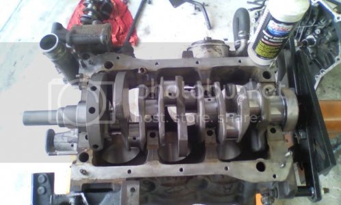

I bought the reman crank from rockauto. Very nice and well done. They cut .25" into it because thats what the main bearings and rod bearings are. Also the seal surfaces were resurfaced very nice. Came with Clevite main bearings, rod bearings, and thrust bearings also. All for 230 something plus a small core which isn't worth me paying to ship it back. If you really need a crank cheap, I'll give you my old on, just pay for shipping. No bearings including. Everythings perfect on it, crank and main jornals are great, just a scratch where crank seal goes that could be machined out.
Crank
Crankinstalled
