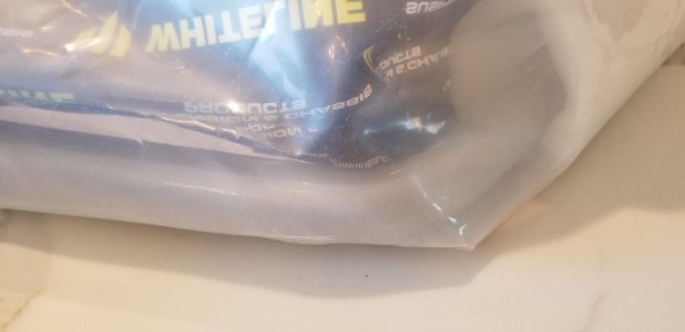

IMG 20201110 171731 Found this at the door when I got home.
Took me roughly an hour to put on.
Pretty good fit. Took a test run. Rear end gives much more feedback now. Single-sided road dips are now more pronounced.
The car actually feels much more secure and turns in with what feels to be a reduced amount of steering wheel turning to get around the corner. I'd have to take it to the track to tell for sure but this is pretty f****** amazing. It's not perfect but it's a really good step along the way for better handling.
I used the stiffest setting on the sway bar for my 2010 MKS. I give it three thumbs up.

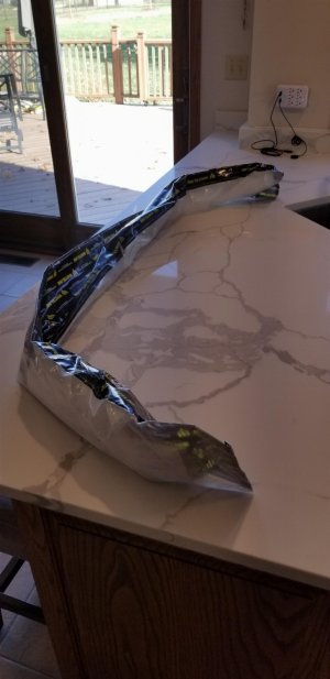

Ok, so I've seen all sorts posts showing a box, a couple asking what's in the box.
But I am puzzled....... why in the F have none of you OPENED the damn box???
Hahaha. That said, I recv'd mine today!
