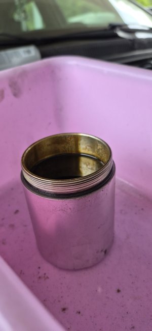

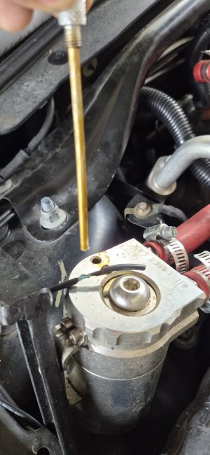

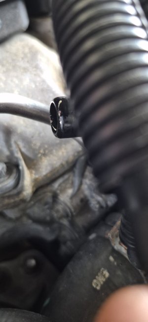

Update: we might be back in this. I checked my catch can and found this:
20260424 150201
Full to the top and saturated everywhere. So pcv stuck open? Pulled the oil separator and pcv valve and cleaned both thoroughly, seafoamed the car to clean up any residue and now it's idling and almost completely clear of smoke.....mayyyyyybe, just mayyyybe

Okay, maybe not, it filled the can back up in 15 minutes. Changed the pcv valve for a new one, same thing. Valve cover? I've heard the valve covers are different on 15 plus for the pcv system, mine are the original aluminum ones.
What could cause it to blast that much oil into the can that quick???
1. Catch can itself can be creating excessive pressure/vacuum pulling oil hard. I would ditch the generic one you’re using. This may simply be the fix.
2. Large PCV opening with excessive vacuum at idle, but you ruled it out by replacing the PCV valve.
3. Elevated crankcase pressure.
My suspicion is high crankcase pressure. It could be because of clogs/sludge, damaged valve cover seals, or a piston ring that is not sealing and pressurizing the crankcase during combustion. That is if your intercooler outlet and throttle body aren’t soaked in oil.
Underfill your oil by one quart so 5 bottles and mix with a strong engine flush like LiquiMoly Pro-Line. Keep it idling for the longest allowed time with the engine warm. This will help clean up any sludge or clogs that may be causing high crankcase pressure or restricted PCV breathing raising the pressure.
Next, pressure test each cylinder and inspect both valve covers. If your catch can fills up in 15 mins and smells strongly of gas and carbon I’d highly suspect excessive blow by, especially if the car is only idling.
Two signs for high crankcase pressure: dipstick popping/rising up a little when you check it, or feeling pressure upwards when you open the oil cap with the engine running.

dip stick and oil cap have zero pressure when taken off at idle, couldnt do the flipped cap because of the angle so I covered the oil fill with my hand for a few seconds and moved it around to try and hear a pulse and got nothing. the oil separator on the 13-15s is external, I flushed the engine just a few hundred miles ago and when I did that I cleaned all the pcv equipment....with brake cleaner.... so its my suspicion that I ruined the seal, more importantly the return seal on the bottom of the oil separator that is supposed to be one way only and if it fails will fill the oil separator with oil and create a lot of pressure as well thus huffing it into the catch can. I ordered one of the last few ford ones I could find and ill see if that does the trick this weekend. If not I will try removing the catch can all together and see if that changes anything. beyond that all I can think of is Im missing the crank case pressure being up, maybe the last engine flush knocked something loose and its just now rearing its ugly head.

I had a similar issue with horrible oil smoke coming out of my exhaust at idle like I blew a turbo seal and it was because of the VTA breather I tried with 10 AN lines. Goes away with WOT and comes back at idle/off throttle.
I reverted back to my vacuum assisted UPR catch can and everything was solved like it never happened. I figured the car needs vacuum at idle to prevent excessive PCV oil vapor condensation from flooding the clean side. It took time to burn off the condensed oil but after a few runs the smoke was totally gone like it never happened. My point is you can’t judge right away.
