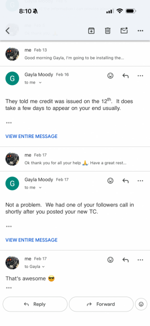

I received the core refund + tax. The total all in for this Stage 3 custom converter shipped after taxes is $2,655.11. Gayla mentioned this. IMG 8142
Heck yeah! Hopefully they get a handful of orders from this and the IG post I made. The converter is going in very soon. Ryan is ready. IMG 8143

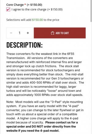

Ok @KSHO11 brought this to my attention.
GH has added their TC offerings to their site. Let’s include this in this thread. IMG 8225IMG 8222
Some heavy hitting marketing language but great marketing response to Precision of New Hampton.
It’ll be great to see data from this. Maybe some before and after 60’ hits and stall changes with load but it is refreshing to have this now listed. I respect that.
