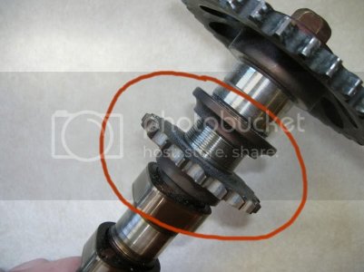

The other ones will need to be checked.
Look for this when you pull the cam covers off. Granted it's been completely spun and you can see the metal shavings on the camshaft.
Spuncam1
Note how the gear has walked up the camshaft leaving grooves in it.

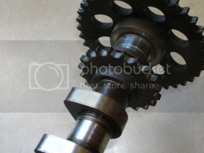

Same cam but its where it "Normally" should be.
